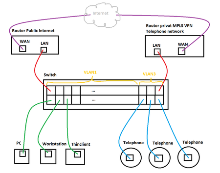

VLAN splitted IT and Telephone configuration
Dear Community, I'm currently setting up a configuration and this point the problem is that the telephones do not send their DHCP Request to the Router behind the Switch. I assume this might be a...

Option 1 is only valid if the PC connects into a LAN port on the phone, and the phone connects into the switch, this would be using a Tagged port on the switch. It seems that you will not use this. In this option the PVID is not relevant as PVID is not relevant on a Tagged port.
Option 2 is also possible to work and in this setup, the untagged port must be set with the correct PVID (assuming it is 3).
Going back to your original post, it mentions that ports 37 to 46 are untagged VLAN 3, yet it doesn’t have a PVID of 3, so effectively they are still operating as untagged in VLAN 1.
Kindly set these ports (which contain phone and the router for the voice network) to be Untagged in VLAN, and also set the PVID to 3 and let us know the outcome.
This port 37 on your config, there is no PVID set, so default is 1

You are right. All IP phone ports should set as tagged ports on VLAN 3. Since the MPLS router is not VLAN-aware then leave that port as untagged.

- AOS-STAHL-ITFeb 14, 2017Aspirant

- DaneAMar 01, 2017NETGEAR Employee Retired
Just following-up on this. I inquired your concern to a higher tier of NETGEAR Support as well as the options mentioned by your vendor and here is the feedback I got:
Both of the vendor comments are correct, but they are depending on how you use the phones:

- AOS-STAHL-ITMar 02, 2017Aspirant
Hello,
I can confirm that using Option 2 using untagged Ports to central Routers and Telephones works WHEN the Voice Vlan is explizit set on the Ports in the PVID Menu additionally.
I dont understand why this extra setting is needed on Netgear devices but its okay to deal with, when you know what is important.
