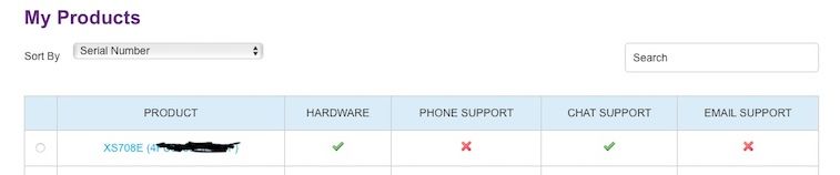

As the subject says, every time I log into my switch, I get this annoying pop-up. I've read several posts in the forums dating back to 2018 but have yet to come across a solution.
What's strange is:
- The switch is registered (registered it online the day I received it)
- I'm on the latest firmware
- I've owned this switch well over a year, but the pop-up nag is something that started occuring in the last few months.
Is there a solution to get rid of this? I apologize in advance if it's been listed here in the forums. I read a ton of posts but never came across an actual solution. Any guidance would be very appreciated. Thanks much.
  • I registered my device (again) this time in the insight app, signed out of the app and so far so good, no messages. I guess I can take my tinfoil hat off now :smileyhappy:
