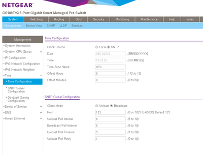

So:
If I move the management-vlan to out-of-band (which is hard to do, because it refuses to do it from the web interface, you need to upload a configuration file with the management-vlan set) then it still blocks.
However: if I configure sntp broadcast syncing or disable sntp at all, suddenly udp port 123 broadcasts are forwarded, independent of the VLAN.
I would have settled for an OOB workaround, but I can not settle for a managed switch that I can't time sync. I need port 123 broadcast forwarded, it's a switch.

- Retired_MemberJun 11, 2020
Sorry to reply you later, this's by design on GS108Tv3 that SNTP using unicast mode by default, device drop UDP broadcast over port 123. If you don't mind, please change client mode from unicast to broadcast, the UDP broadcast over port 123 could be forwarding successfully.
Let's know if you have any, thanks.

- ArdjeJun 15, 2020Guide
Hi Retired_Member , you will understand that a switch that does not forward udp port 123 packets on any vlan, because the management cpu that is in it's own management vlan, is using unicast as it should, is unacceptable? It's perfectly fine for me if it doesn't forward it on the management vlan, because it's a table switch after all. And if you have read the thread, you would see, I've already discovered that it always blocks.
But the management of the switch should not interfere with switching.
Now on to broadcasting: to work around a bug in a switch I have to add broadcasting ntp servers on each management domain. Since the switches are pretty limited, I also need to have multiple management domains and per domain a local server that does unicast ntp and broadcasts it to one or more, or have a hell of an l2 design.
I get that you must protect the host cpu, but it's a bug caused by a cheap work around against a possible ntp exploit. Make it less cheap by only filtering the management vlan. If people don't use management vlans, they also don't care about udp port 123.My target networks are not office tables, it's large halls with machines where being able to get access to a network port is a security breach on it's own. Our need for network ports is that high that we included switches on our own hardware. But these are machine internal switches.
