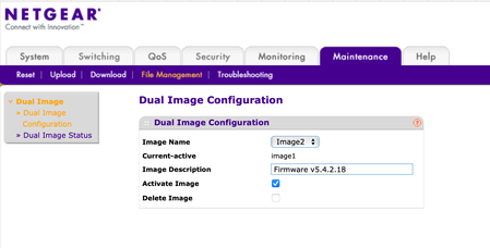

Can’t update firmware on GS108Tv2 (chat support agent stumped, too)
I have a GS108Tv2 with very outdated firmware. It is on Version 5.4.2.13, which goes back to at least 2014. I would like to get it up to 5.4.2.36, which is only two years old. I have gone through...

I had the same issue with my GS725Tv3, what worked for me was after I got that error when trying to activate image 2 I did a reboot from the device reboot menu then once it reboot I saw that it went to image 2.

I myself got it working eventually, but I was going back and forth on this and that so many times that I would not be able to reproduce, what I ended up having to do to accomplish the task.
