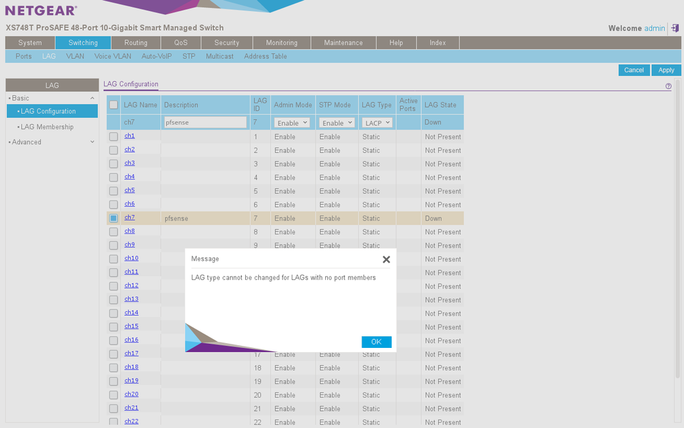

can not change LAG Type to LACP . XS748T ProSAFE 48-Port 10-Gigabit Smart Managed Switch
Hello

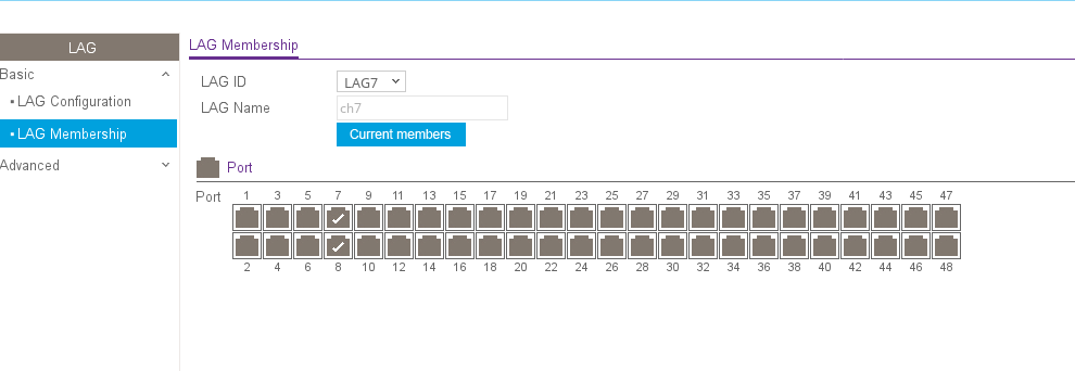

I set up LAG7 with ports 7 & 8 as members.
yet at LAG Configuration i can not change LAG Type from Static to LACP.
this error displays: "LAG type cannot be changed for LAG...

- robfantiniMay 28, 2018Aspirant
OK I'll try that an it'll probably work.
also this is a bug. you know that right?
since 10 other models do not require this work around.
I know you probably do not do the switch low lebvel programming. However others will run in to this - and it should be fixed with a firmware upgrade sometime .
