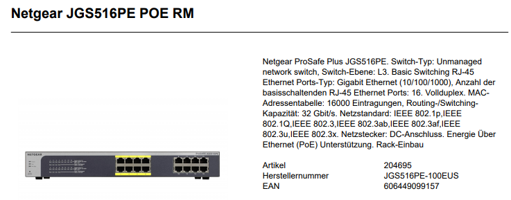

The original data sheet from the planning stage of the project says JGS516PE is an unmanaged switch (this data sheet is not from Netgear themselves it seems):

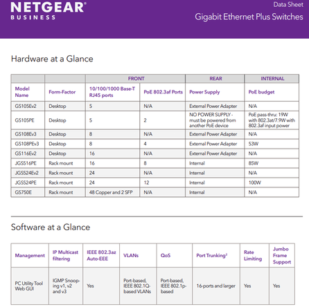

A data sheet downloaded from Netgear website says JGS516PE is a gigabit ethernet plus switch:

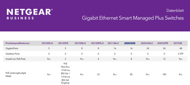

yet another netgear sheet says JGS516PE is a gigabit ethernet smart managed plus switch:
(Because I am in Germany the netgear website sometimes switches back to germany hence the mixed languages)
It seems that the JGS516PE is a managed switch for sure and the first data sheet confused JGS516PE  with the unmanaged JGS516.
What is the difference between a smart managed plus switch and a plus switch?

  • Hallo ChrisWhatever ,
    Thank you for choosing NETGEAR switch JGS516PE.
    This switch is a layer-2 managed switch, and is called a Plus switch. Plus switches used to be called "Smart Managed Plus switch" and have been changed to "Plus switch" recently.
    The document updates might be delayed at channels. Nevertheless, you could find the up-to-date information on NETGEAR official website for our products and services. Please refer to the latest datasheet on our website.
    https://www.netgear.com/media/Gigabit_Ethernet_Smart_Managed_Plus_Switches_DS_tcm148-69702.pdf
    Thanks,
    Iphie
