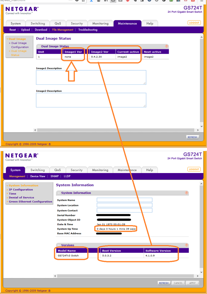

I'm trying to repurpose a GS724T v3, and it's not going like any other Netgear switch I've ever seen.
I'm hitting two issues. First, I've gone to the usual "HTTP download", selected the latest firmware .stk file (5.4.2.30) to upload into image2  - and the switch just saits there "waiting" when I click "APPLY" - it says to wait until it completes, then there's no moving bar or other status indicator,  and no success or fail message. I've left it up to 5 minutes but - nothing.
I tried this maybe 8 or 9 times, with repeated resets, hard resets, power offs, paper clip in the factory reset button.  Eventually, after maybe 40 attempts and 3 hours repetition, it seemed to have accepted the latest firmware into Image2, see screenshot.   I set image2 as the active image and rebooted - and yet it still showed the old firmware version on the switch home page, when it restarted. Amazed and completely frustrated, I've even gone as far as deleting image1 as you can see, then rebooted again - and it's simultaneously saying it has only one firmware image loaded (5.4.2.30) which is the active image, and also that it's still booted and running 4.1.0.9.
(A) What the heck, and (B) how do I fix it?
Thanks for help understanding this!!

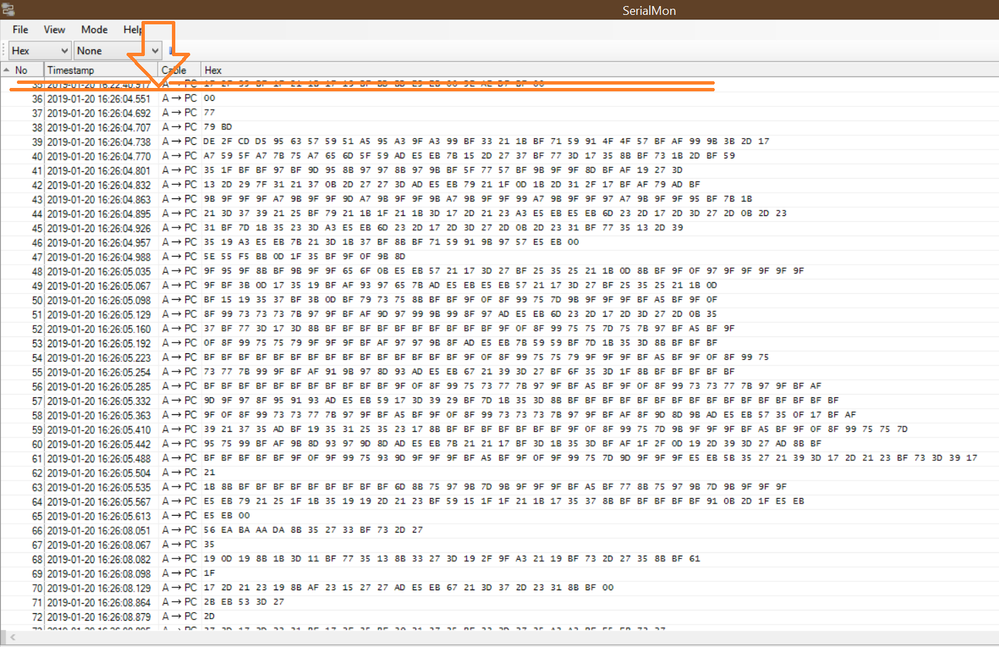

      So I'm now in the same boat as many others. Fortunately I already have a Prolific USB to serial cable/adapter. (It's quicker to self-fix really).  I seem to have a good serial link, but I'm stuck now, because I'm getting consistent and identical gibberish at switch bootup. However, there are so many threads by owners of bricked switches, that the solution also seems to be on these forums - apparently one needs an RS232 TTL converter, not just a "usual" USB to RS232 converter?
      After that information, the trail ends, so I have some questions left over about the procedure.
      1.  Can anyone recommend an appropriate and cheap EBay RS232/TTL dongle for the UK, as it's way too easy to buy one that's not going to work, and spend ages wondering why. I'd rather find out what exactly is needed, first.
      2. Does the RS232-TTL dongle plug onto the USB-serial adapter or replace it?
      3. How can I tell if I have the RX/TX the right way round? The page everyone links, is ambiguous when it says which way to connect them. It's not made clear whether "RX/TX" on the photo next to the pins, mean "this is the board's RX/TX" or "This is the pin to plug the cable's RX/TX to", just that the RX of one should connect to the TX of the other. Could my gibberish be because I've got the pins inverted or something?
      4. Do I need to set a charset and what should it be?
      Below are screenshots of the gibberish - one is the console from PuTTY, the other is a hex dump of it from boot using SerialMon. The connection was at 2400 to make sure it wasn't due to speed issues. Exact same data received at other speeds and settings. That's a bit of a worry, because if the issue is voltage (TTL vs RS232), why would I get absolutely consistent - but complete gibberish - data from it?)
