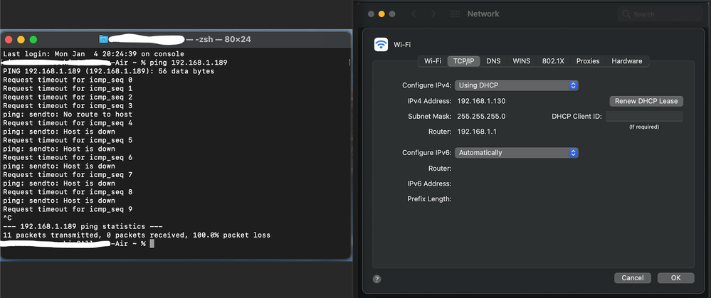

I think I inserted the wrong terminal code for pinging the switch.
Please see inserted images which are screenshots from my Macbook Air (MBA) connected via ethernet cable to the switch. The first screenshot is of sending a ping to the switch's IP address when the ethernet cable is hooked up and when the WiFi adaptor is turned on - in which case the WiFi normally takes precedence. Ping-to-switch_with_WiFi_on

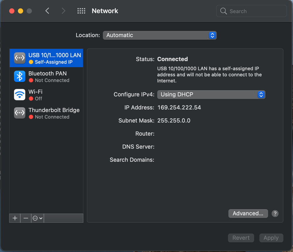

As expected, the ping does not work when the MBA is connected to the switch via ethernet cable with the WiFi turned off, and with the LAN port IP is set to DHCP. (self-assigned IP address is 169.254.222.54) MBA ping to switch fails with this MBA network/IP configuration

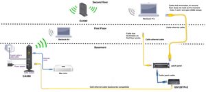

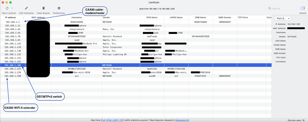

I don't believe the port on the CAX80 (that connects to the switch via a CAT8 cable) is the issue. Reason being is because right now I am on my Macbook Pro which is wirelessly connected to the EAX80 (with my network devices setup as illustrated in my initial post), and I ran an app called LanScan. Upon starting the scan, all the devices on the network populate on the list almost immediately except the switch. But - after about 1 minute the IP address and correct MAC address for the switch populate on the list as well.
In other words, the LanScan app running on my MBP is able to pickup the switch, although with a delay, in which my MBP is wirelessly connected to my wifi-extender --> extender wirelessly connected to CAX80 --> CAX80 connected via cat8 cable to switch.
So why is it that the user interface for the CAX80 does not have the switch listed as a connected device? This makes me think I don't have the routing settings correctly configured in the switch's GUI?

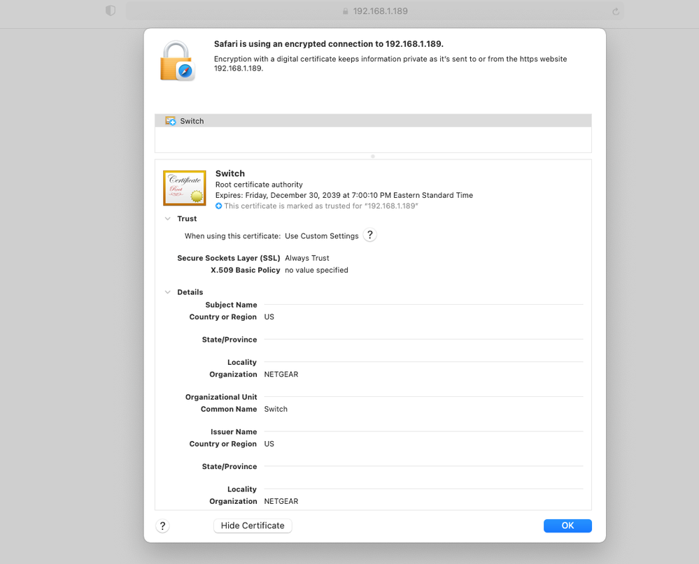

Around ping 157 I typed 192.168.1.189 into my webbrowser on my MBP, and the pings were successful for a bit longer - I then had to allow my browser to trust the address...request timed out from pings 170 - 226...after trusting the Netgear certificate I refreshed the webbrowser around ping 258 and then the pings are successful off and on. The login screen for the switch user interface never populated in the webbrowser.
I terminated the terminal request after ping 405. Please see the attached pdf file.
