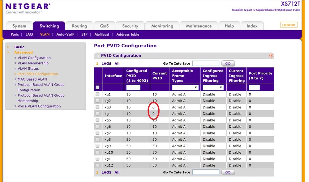

"Current PVID" auto turns to ZERO
I have a Netgear XS712T 10GbE switch as my main switch off my router.  I have a couple VLANs going for Management, Main Network, Guests, etc.  Off this XS712T, I have a ProSafe GS750E switch that I've set up the trunk port in a LAG.  Both ports of the LAG are tagged for each VLAN with a PVID of 10 (the Management VLAN).
In the XS712T, I'm unable to tag the ports, they can only be set to "U" and when I try to set the PVID to 10 (the Management VLAN), it defaults the "Current PVID" to "0".
The switch and the LAG seem to work, however I can not access the GUI unless I plug directly into the switch.
What am I doing wrong?
  • For the LAGs, you must configure tagging and PVID on the LAG, not on the individual ports. The Current PVID on the ports will always show 0 as long as the ports are member of a LAG. SImilar for the LAG VLAN association for T or U - do it on the LAG level. On the PVID settings, open "LAG" or "all" - there you can configure the l1..l8 PVID.

  • schumaku's avatar
    schumaku
    Regards,
    -Kurt
    • ARAMP1's avatar
      ARAMP1
      That makes sense however, on the other end of the LAG, the ProSafe GS750E, it shows T on both ports for each VLAN and shows the PVID as 10.
      Maybe it's different for a different line of switches?
      • schumaku's avatar
        schumaku
        Definitively, the Smart Managed Plus (e.g. GS750E) are very basic Web managed switches. Some switch models are merging the information for LAG and their ports, some allow even almost contradictorily configurations for LAG pots vs LAG, and others suppress the ports used in a LAG (so things look empty). Very confusing, we always try to show these details while Beta testing, with mixed results.
        On top of all that, the XS712T does still have the "old" (almost legacy) Web interface, while newer XS variants come with the newer Web UI design.
