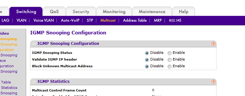

    What network topology you have deployed, simple daisy-chain of the switch (trunks), a basic hub-and-spoke - or what for you are so keen to configure the bridge prio?
    What kind of Multicast traffic you generate there?
    Some industry standard ICMP based Multicast control as in use for many Live TV or video distribution?
    Probably you might habe to configure ICMP Snooping here:
