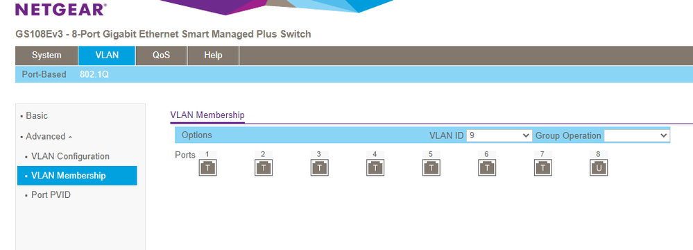

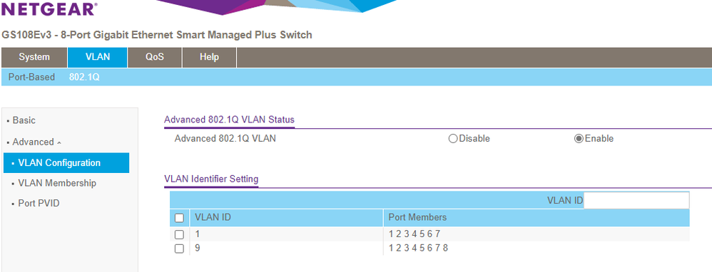

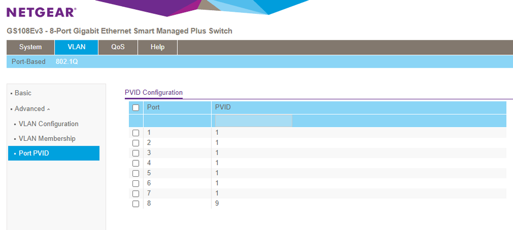

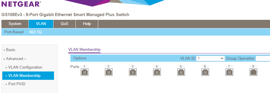

I have multiple GS105E V2 switches and setting up two vlans between them is no problem. My TV Vlan en Network VLAN are working fine.
Because I have multiple connections next to my Router I added a GS108E v3 switch and setup that indetical.
VLAN 802.1q -> Advanced mode:
When I connect two GS105EV2 switches all works fine. But the GS108EV3 will not work. As stated the above setup is indentical on all my switches.
Is there a known issue or did I miss somting? Would like to use my 8 port switch in the center of my network/
  • I already found the solution. For my TV Vlan IGM Snooping need to be turned off on the GS108Ev3 switch. Strange is that for the GS105Ev2 it doesn't make any difference if IGMP Snooping is turned off or on.

      What exactly does not work on that GS108Ev3?
      • Connection from my TV VLAN (number 9 is not established)
      Have all the required VLAN configured on the GS108Ev3?
      • Yes I have on VLAN 1 (Normal network) and 9 (TV)
      Have a VLAN trunk configured between the GS108Ev3 and a GS105Ev2 with each VLAN tagged for the link (or the base VLAN untagged and set the PVID on both ends accordingly)?
      •   I Used PVID. All default VLANS untaged and vlan 9 taged where I have upling ports
      Have configured an access port on the "non-working" GS108Ev3 to participate on this one VLAN, untagged, and same VID and can't get a connection to the same VLAN on the other switches?
      • cORRECT

      • schumaku's avatar
        schumaku
        Afraid, still waiting for a moderator to approve the screenshots.
        Have removed any other VLAN membership from the access port where the TV is connected to?
        Where from is the TV VLAN get it's feed from'
        Does another switch with a similar config allow to run the TV?
        And yeah, used the correct ports configured on both ends for the link? Happened to me before, too...
