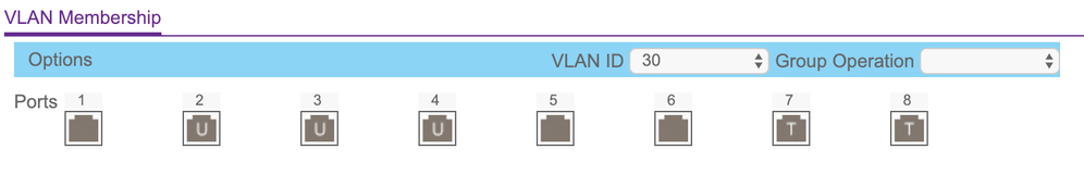

I originally posted this on the Ubiquiti forums, but have determined that my Netgear GS108PEv3 appears to be the issue.  Details of my network and problem are below:
I have setup a Ubiquiti Edge Router Lite, and almost everything is working as planned--except my guest vlan has the ability to ping a single address on the management vlan.  Specifically, when I log onto the guest wifi, I get a 10.0.20.X ip on vlan 20, which I want. I am not able to ping 10.0.20.1, 10.0.10.1, 10.0.10.3, 10.0.10.4, which I also want...but I AM able to ping the Netgear GS108PEv3 switch at 10.0.10.2, which I don't want.

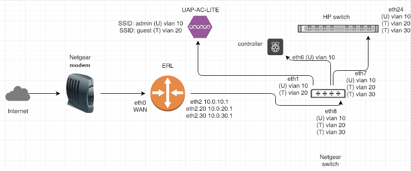

My setup is as followed:
AP
I have two SSID:
Admin Untagged on VLAN 10
Guest Tagged on VLAN 20

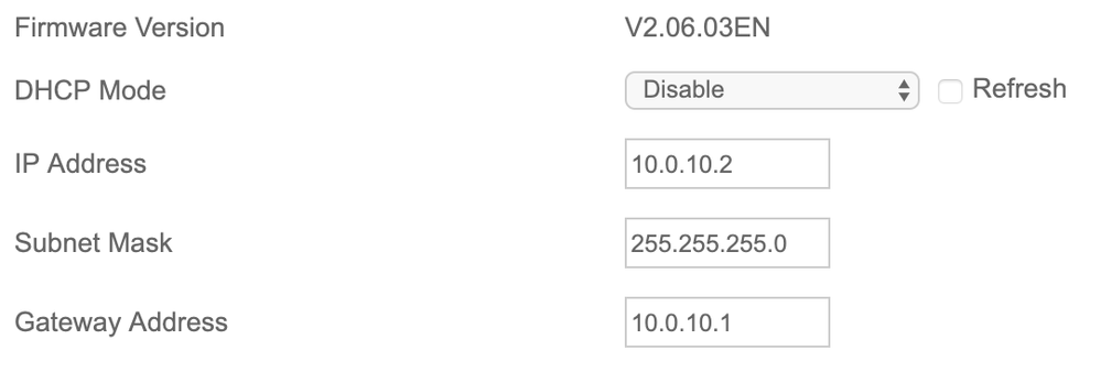

Netgear switch ip 10.0.10.2

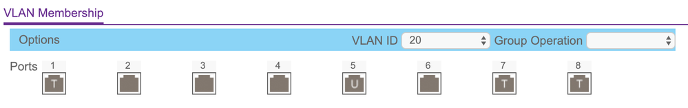

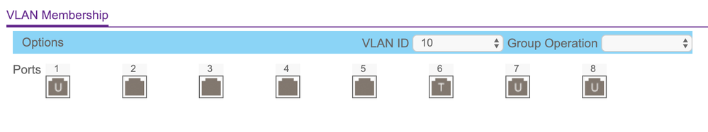

Port 1: Untagged VLAN 10, Tagged VLAN 20 (to AP ip via DHCP)
Port 6: Untagged VLAN 10 (to controller at 10.0.10.4)
Port 7: Untagged VLAN 10, Tagged VLAN 20, Tagged VLAN 30 (to HP switch at 10.0.10.3)
Port 8: Untagged VLAN 10, Tagged VLAN 20, Tagged VLAN 30 (to ERL router at 10.0.10.1)
HP switch ip 10.0.10.3
Port 24: Untagged VLAN 10, Tagged VLAN 20, Tagged VLAN 30
ERL Router
eth0: WAN
eth2: 10.0.10.1 Untagged VLAN 10
eth2.20: 10.0.20.1 Tagged VLAN 20
eth2.30: 10.0.30.1 Tagged VLAN 30

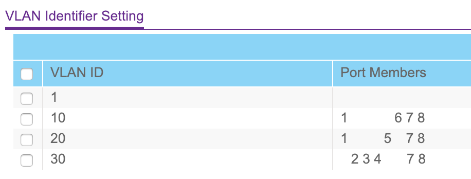

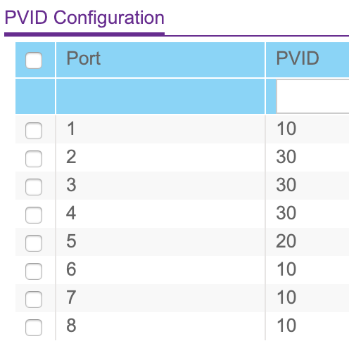

Some additional photos of my settings in the Netgear switch:
My firewall rules:

Here is the link to the UBNT forum with lots of TCPDumps as well:
Netgear switch responding to pings from guest VLAN
TLDR;
My Netgear GS108PEv3 appears to respond to pings and is reachable via browser from guest vlan when my firewall rules and router config appear to be correct.  Maybe I am missing (or messed up) a setting on the GS108PEv3 switch?  I've removed the switch and replaced it with a cheap Zyxel managed switch and I am NOT able to reach the management VLAN from the guest VLAN, which is what I want.  I upgraded the firmeware, factory reset the Netgear router, and reconfigured it, only to be able to hit the Netgear switch from guest VLAN--which is what I do NOT want.  How can I ensure this switch is NOT reachable via a guest VLAN?  Did I possibly misconfigure this switch?
  • No, this is a limitation of the platforms used for most Smart Managed Plus switches (GSxxxE) - the CPU port can't be restricted to a certain VLAN only. Bet you have no such control for a management VLAN on the UI (only few Smart Managed Plus have, like the XS724EM). And just based on the IP address the switch won't "magically" add a VLAN config or ACL - the management IP is active on all VLANs on these models aimed to be very lightly managed, that's all.
    Wonder why you posed on the other vendor forum - it's clearly a (well known, many times) discussed and explained limitations of these very simple managed switch family.
2 Replies
  • schumaku's avatar
    schumaku
