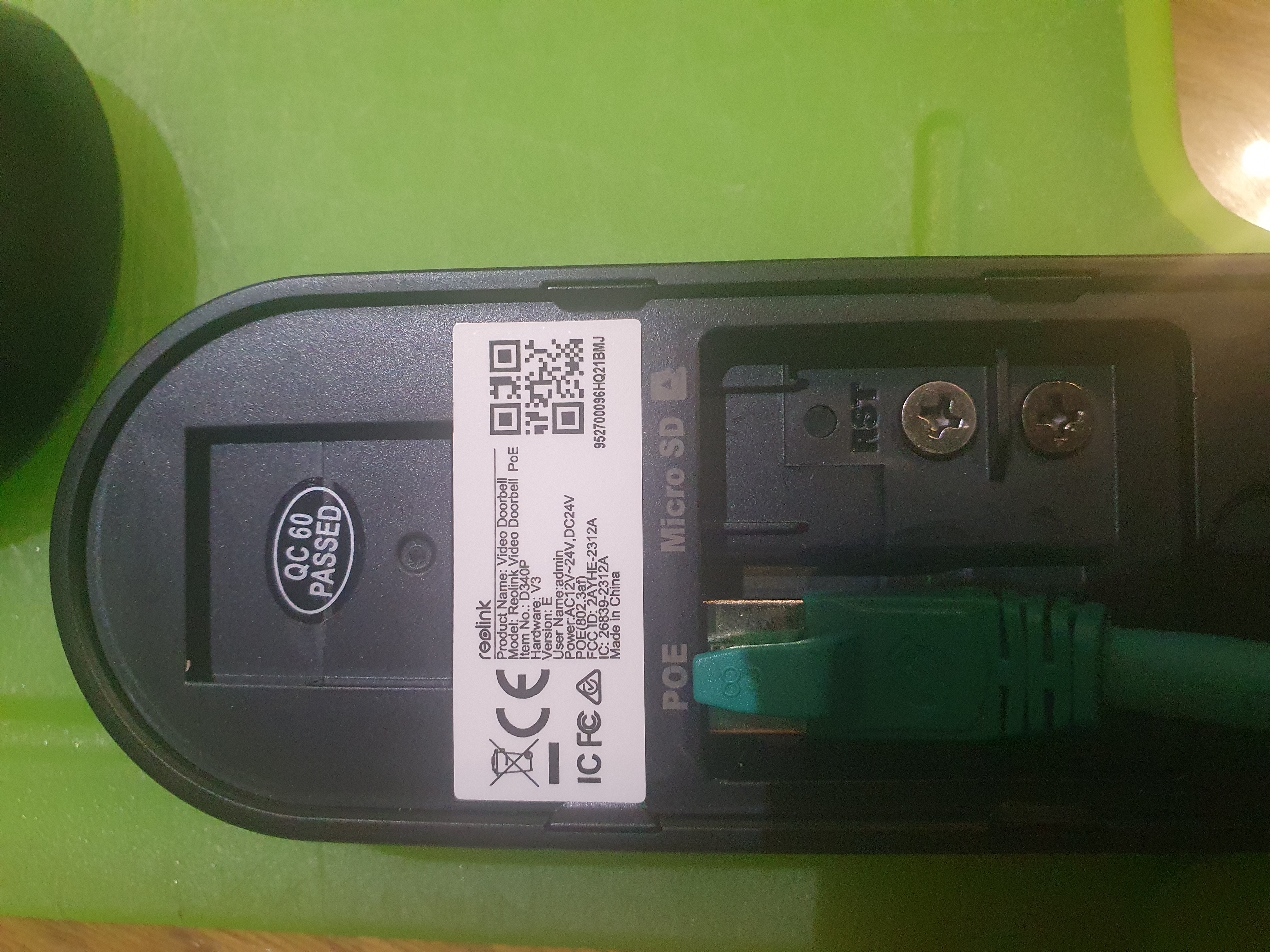

GS308EPP PoE & REOLINK PoE doorbell
GS308EPP:
Port (PoE) doesent work regardless on the PoE setting with my NEW PoE Reolink doorbell (V3) -->IEEE 802.3af
What is strange is the fact that the PoE and data transmiton works fine with CAT 5 cable (without shield)
As soon I insert CAT 7 cable which is actually installed, it stops working.... The cable is the original patch cable 20 m long.
https://profipatch.com/profipatch-cat-6a-s-ftp-rj45-mit-cat-7-rohkabel-pimf-halogenfrei-lszh-premium-awg26-rj45-schirmblech-vergoldet-dsl-ethernet-tv-netzwerk-lan-10gb-gruen-20m
The cable was tested with professional tester and all good...
Any setting I try with CAT 7 cable (IEEE 802.3af, IEEE 802.3at,..) it just doesn't work (green status light blinks sometimes but not delivering any power)
If I try using standard PoE injector (802.3af) with the mentioned CAT 7 cable it works normally...
I also tried to use different cable (leviton patch cable 6a) and it didn't work as well..
The problem is with the switch.. Not sure where and what are my options...
I also tried to change port (6,7,..) but nothing helps..
Please advise my option or send the replacement... Since I didn't purchase 120 W PoE switch just to use
work around solutions to make it work...
