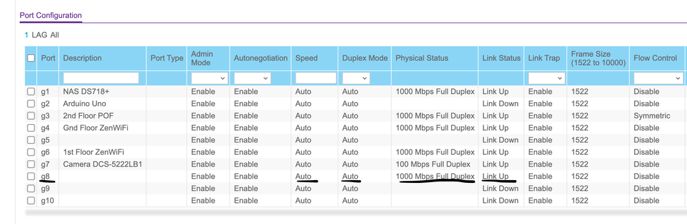

After several attempts of restarts and tweaks both on the Router and the switch I thought about simply moving the cable from g8 to g6 and to my surprise in g6 it works at 1000FD without any problems.
Here is a snippet of the config, as you can see there is nothing special about the port config, everything is on default setting:

Maybe something to note is that g7 is 100FD (and it should be so because that Camera has a 100GbE interface). Is that having some influence on g8?

    Ok, so just to conclude on this topic for anyone who might read it latter.
    I did a software upgrade to 1.0.1.2 and tried again with my MacBook and the 10GbE adapter and now I'm getting consistently 1000FD.
    My guess is that something got in a strange state and the upgrade fixed that. I have tried to plug/un-plug the cable multiple times and everytime it worked as expected (auto negotiation at 1000FD).
