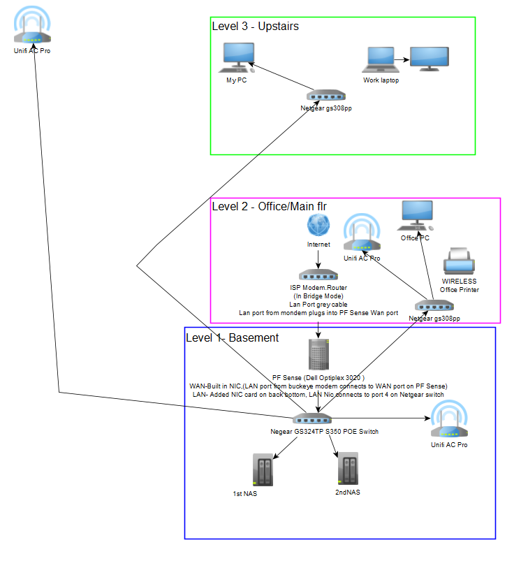

      Generally I have my Hitron modem in bridge mode, connected to my PF Sense box, connected to the Netgear GS324TP. Then the GS324TP connects to  netgeargs380pp. Diagram below to help.
      Yes the picture shows APs but I have unplugged those as well as turned off the PF Sense box so that way I know its literally just the modem and switch working together.
