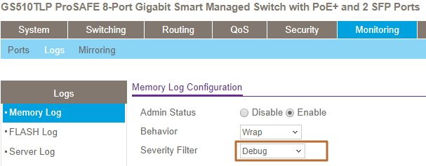

Hi Dave40,
Please only connect GS510TLP with PC, not connect with other device, keep your switch with default configuration(except for enable memory log severity filter as Debug) on v6.6.2.9, to check switch port will flap or not? If still flap, please give the time and frequency, logs.
Regards,
NETGEAR Employee.
