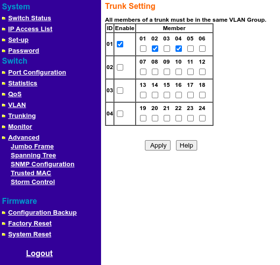

- SparticleDec 06, 2022Aspirant
So just enable a trunk group and select the ports and thats it?
So example. These 2 ports are connected to the vswitch in ESXI 6.7
That didn't work. It caused weird issues on the network.
ESXI does load balancing on the pair of connections and link failover if one of the links fails.
Some kind of mismatch going on.
Still looking for an answer.
CheersSpart
