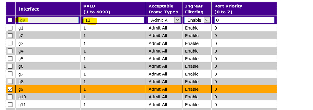

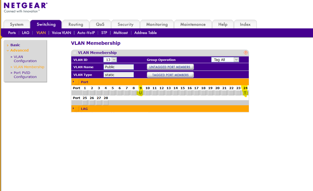

Gs728TP VLAN Isolating a single port with only internet
Boot version: 2.0.0.11 Software version: 6.0.1.14 Port 9 Needs to be isolated from the network but also receive internet from port 24. Ports 1-8,10-23 also need to receive internet from port 24...
- Apr 26, 2021
So create a new VLAN, remove port 9 from any other VLAN, put port 9 [U]ntagged including the same PVID, and make that new VLAN [T]agged on the uplink/router port. Ensure the sub-interface is also operating as tagged for that very same VLAN on the security appliance.

So these would be the only Switch side changes I need to make?
And then just make sure the SonicWall is prepped to expect tagged traffic on VLAN 13, and then provide a DHCP scope for that sub interface, and make the traffic shoot out to the ISP provided IP? Sounds good to me after I get this set up will report back here, soonest being after hours tommorow.
