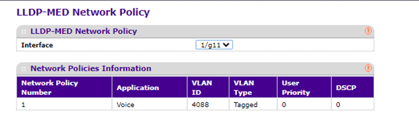

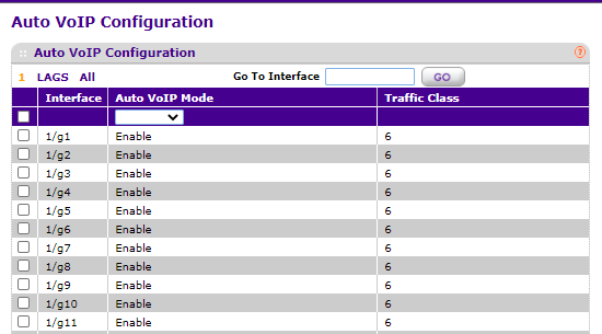

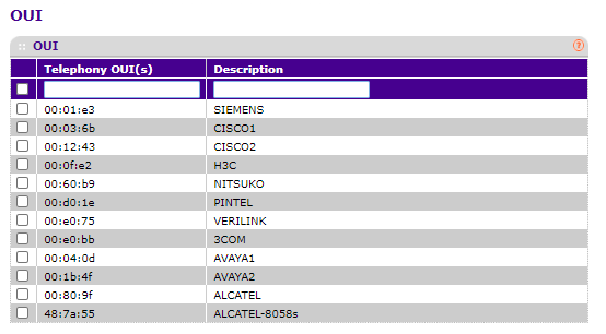

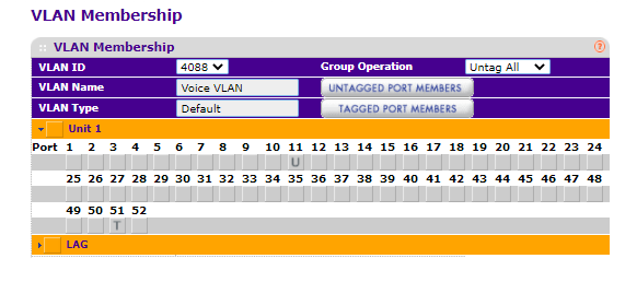

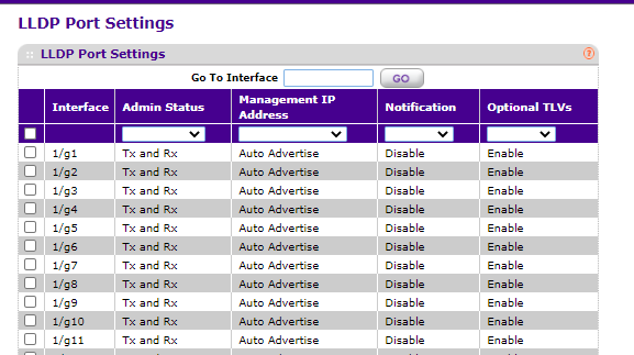

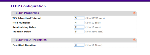

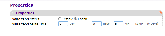

I’m trying to add an Alcatel phone IP on Netgear GS752TPS (firmware 5.3.0.36) switch. When I connect phone to the switch, the port goes to VLAN 4088 Untagged instead of  Tagged.
I did a factory reset and configure from scratch without luck.

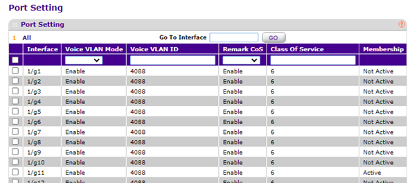

Weird thing is if I disable then enable Voice VLAN Mode, port goes to VLAN 4088 tagged ! If I reboot the port goes to VLAN 4088 Untagged.
Why ports are not going to VLAN4088 Tagged  auto ?
Thanks for your support
Extract of my configuration, phone is connected to 1/g11 port, 1/g51 port is connected to another switch with ip phone server

      Indeed after diagnostic with the support, we disabled auto-VOIP and tagged needed ports to the VLAN VOIP.
