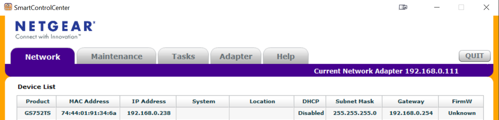

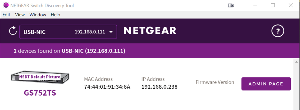

Afterwards the device wasn't any longer detectable in my standard Network (192.168.2.x), but it could be found again with  an additional USB-NIC-Adapter in another Network (192.168.0.x).
The SmartControlCenter shows some missing entries:
I can't connect to switch neither with my own nor the standard password.
That                                   is, what the Switch discovery tool shows:

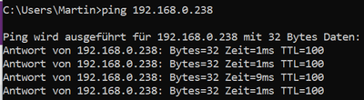

ping is working

    The GS752TXS firmware v5.2.0.20 was the initial firmware release.  The best approach for updating the firmware to the latest version is to do it in a ladderized manner wherein update the firmware from v5.2.0.20 to v5.2.0.26 then, from v5.2.0.26 to v6.1.0.27 and so on until you reach the latest firmware which is v6.1.0.39.
    Based from what happen as you have described in your initial post above, the GS752TXS got bricked since both the power LED and the port LEDs are just lit up orange and unresponsive even after doing several factory reset & powercycle.  Thus, the switch needs to be replaced.
