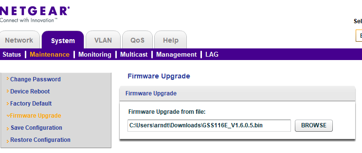

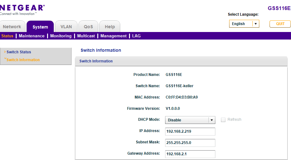

I was trying to update my Netgear GSS116E switch from firmware version V1.0.0.0 to the current version (as of this time, this seems to be V1.6.0.5).
Since the support pages already stated that updating via the Web interface wouldn't work, I installed the current version of the ProSafe Plus utility (2.7.2) and tried upgrading with this version.

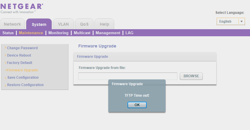

Unfortunately, that did not succeed, I always ended up with a tftp timeout error. I tried upgrading to firmware versions V1.0.0.6 and V1.0.0.5, which are still downloadable on the support page (always rebooting the switch in between via the web GUI), but always got the same result ending with a tftp error
Since upgrading via the web gui is - as I've already read before - also impossible ("invald firmware version") for all versions available, I doubt whether upgrading from version V1.0.0.0 .0to any version above V1.0.0.2 is possible at all.
