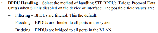

Switch already running latest firmware. Have tried classic STP but I am unable to select Flooding with STP enabled. Tried everything but as soon as you select STP the switch defaults to Filtering rather than Flooding.

Out of interest should I be able to select BPDU to Flooding with STP enabled? As it stands I can't and wonder if this is normal.
