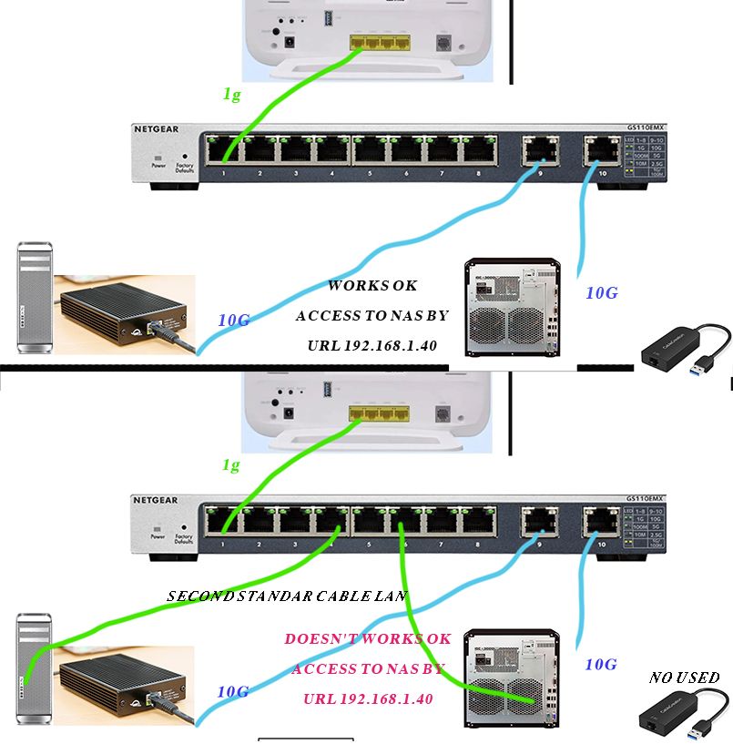

Hi friends, could someone suggest me best configuration to domestic LAN network? I'm afraid to set LAG or config Switch. Now its working, but under perfomance. I've connected my Mac (thunderbolt3 adapter 10g) to Netgear Switch (2x10g upload link + 8 standard ports) >> to a Server (Xpenology 10G Card) . So, Computers can connect between them, but Mac cant find IP Server Synology Page (ex.192.168.1.XX) , however can connect ok by SMB/FTP.  I believe have to Manage Main Netgear Configuration Page and (guess) do a bridge/link in order to discover the IP Server, but I can't do it. Very thank's in advance.
M.
connection structure.
1 Mac computer connected by cable to SWITCH 10G port
1 Server Xenology connected by cabe to SWITCH 10G port
1 SWITCH port 1 connect to Modem
Conclusion:
Mac is avaible to Internet but Cant access by Web to Xpenology Server
Server Xpenolgy is avaible to reach Modem and Internet

      Thk Kurt for suggestions, I'll try to explain better what's happens. I'm attaching this pic in order show what its the problemm. I hoppe became claire now.
      1) Yes , usually I get acces to Synology by WEB static IP 192.168.1.40
      2) I only want to connect Mac to Server Xepnology faster (for edition work), so, for now, Switch only have 2 devices connected.
      3) I would like some tips to "take advantages" to GS100 Switch (ex. how to add more speed connection if I connect a 2.5g device on Server? Can I made a LACP (Aggregation?) .
      4) Why can't acces to Server by Switch if I add two ehternet second cable (1g) ?
      I'll appreciate tips for that!!

      No idea where your reply is gone...managed to keep your informative drawing.
      Keep the simple "Works ok" setting - perfeclty fine!
      There is no added value adding these two 1G links to the very same subnet and shown in the "does not work" 8-)
