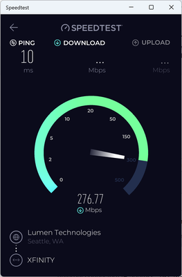

I have had this issue since upgrading my internet connection to 2.0Gbps
I have had this issue since upgrading my internet connection to 2.0Gbps. Performance across the router from WAN to LAN (download) is 200-300Mbps. After trying many settings, enabling QoS without enab...

I am measuring between the LAN and a Pi file server sitting on a Netgear MS108EUP connected to the WAN port. The MS108EUP is connected to the internet via a TP ER707-M2 and Netgear CM2050V. Internet connection at the MS108EUP is consistently over 2Gbps (XFinity), so I've isolated the issue from LAN (1G) to WAN port (2.5G) using file copy performance. The results are consistent with SPEEDTEST to Lumen Technologies in Seattle (800+Mbps from the LAN side, 2+Gbps from the MS108EUP connect min-pc). The internal LAN performance is 800+Mbps using file copy.

Yes, I have tested every combination, and I understand the 1Gbps LAN will limit perf, this is expected. I have the 2.5G WAN port enabled and connected to my 2.5G switch and 2.5G Modem (via ER707-M2) which can get 2.0+G as measured on my B100 Mini PC via SPEEDTEST. I disabled DoS protection on the RAX200 on a hunch, LOL. So far so good. Theory here is the DoS protection is identifying the speed test as DoS and......throttling it.
