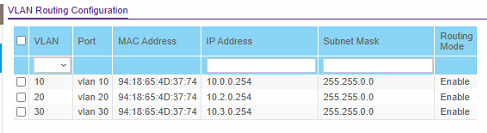

Hello, I have a configuration with three different VLAN where I want to enable the routing between them.
The configuration is the following:
VLAN ID  10
IP 10.0.1.254 255.255.0.0
Port in the range 2-10 and every port have the PVID 10
VLAN ID  20
IP 10.0.2.254 255.255.0.0
Port in the range 11-16 and every port have the PVID 20
VLAN ID  30
IP 10.0.3.254 255.255.0.0
Port in the range 17-24 and every port have the PVID 30
If I try to connect a PC to a port belonging to VLAN10 and set up the network card as:
IP address 10.0.1.2
Subnet Mask 255.255.0.0
Default Gateway 10.0.1.254
I obtain response to the ping only from the gateway 10.0.1.254. No answer from the other VLAN IP e from every PC connected to those VLAN. I obtain the same result from any other VLAN.
The managmente VLAN (ID 1) is confined to port 1 and 2 of the switch.
I tried many times resettig the switch to the factory configurations. I tried to use the VLAN Static Routing Wizard and set up everything manually but nothing changed.
The Routing mode is enabled.
I saw that the routing table remain always empty.
I looked for a solution in many forum but i didn't find anything. Any Idea of what is missing? Thanks

    What hits my eyes is that all three networks and VLAN 10.0.x.x with the 255.255.0.0 mask are in the very same IP subnet - so not routing can ever happen.

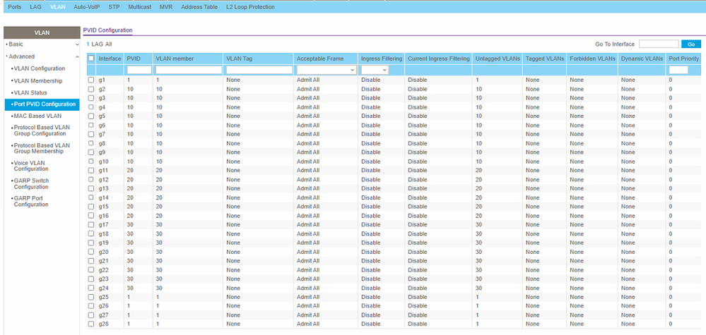

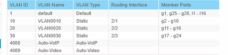

      Sorry, there were some errors in the Ip the I wrote.  I tried to recreate the case by creating distinct subnets. I attach some images to better clarify the situation. Each port in a respective subnet belongs to the VLAN only and has its PVID associated with it.
      The default VLAN 1 is used only for managment porpouse in order to not interfere with the remaining VLANs.
      IP address 10.0.1.2
      Default Gateway 10.0.0.254
      I obtain response to the ping only from the gateway 10.0.0.254. No answer from the other VLAN IP and from every PC connected to those VLAN. I obtain the same result from any other VLAN.
