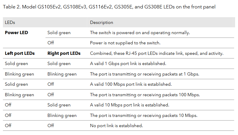

Additional information: the switch seems to be in 1000M at the beginning, the two green lights flash, then go out 2 times and then only one comes back on.

The Orbi router should display the speed of the LAN port that is connected (through the house wiring and patch panel) to the switch as the same speed as the LED's on the switch port:
i.e. Both left and right LEDs solid green on the switch should match 1000M/Full (Gigabit) on the router display.
Left LED green and Right LED off should match 100M/Full (Fast Ethernet)
This appears to be what is happening, correct?
