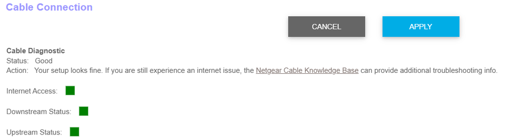

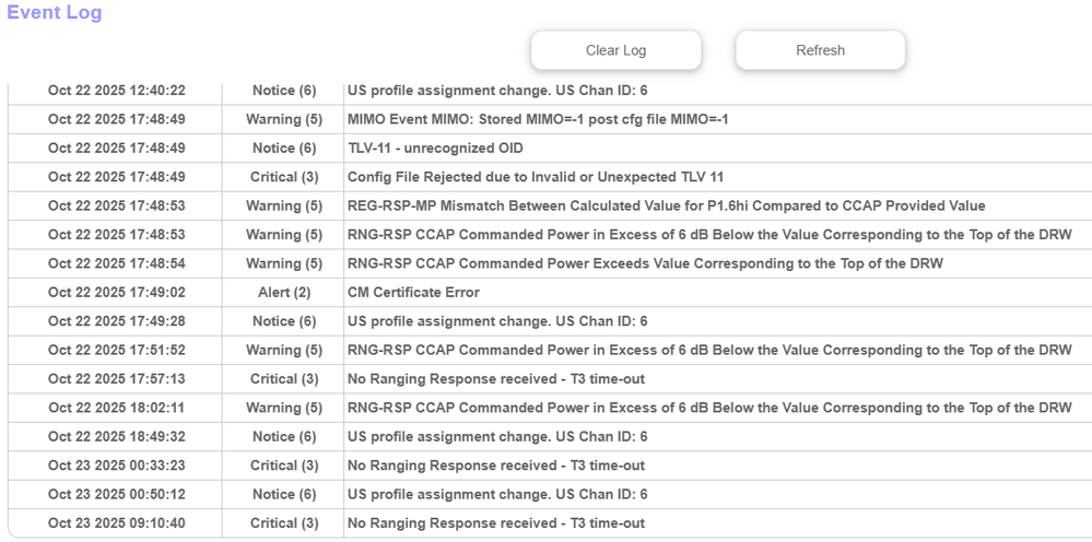

Thank you. I have cycled the router/modem as indicated. WIFI speed consistently drops from 650 to 200 which correlates to drop of streaming music. Please see below.
Please include the data on the page farther down the Cable Connections page.
Any Criticals, Errors or Warnings seen in the event logs needs to be reviewed and resolved by the ISP. Indicates a signal issue on the ISP line up to the modem.

Your logs look like you have line issues. But we can't tell you to high/low/or just errors in the line without the cable connections page.

Although not cleared by me, my Events Log is suddenly empty?
