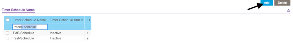

      Add a new Timer Schedule
      Add new Timer Schedule

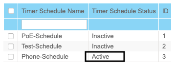

      The Timer Schedule is active
      The new Timer Schedule is active - but with no Schedules attached yet

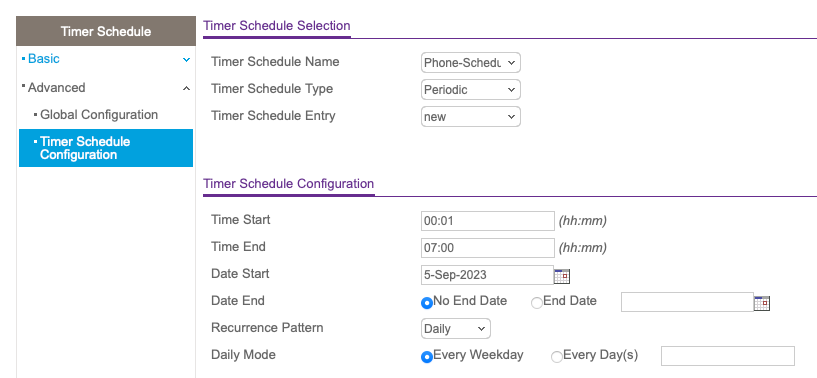

      Add a periodic Schedule to the Timer Schedule
      Add the new periodic schedule to the Timer Schedule by clicking on the <Add> button (not in the screenshot). It makes no difference if I use a day in the past, todays date or some day in the future for "Day Start".
      According to the documentation this schedule will run (ie switch off POE) Mon-Fri from one minute past midnight until 7am.

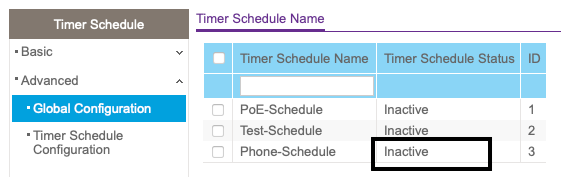

      The Timer Schedule has become inactive
      Now the Timer Schedule has become inactive.
