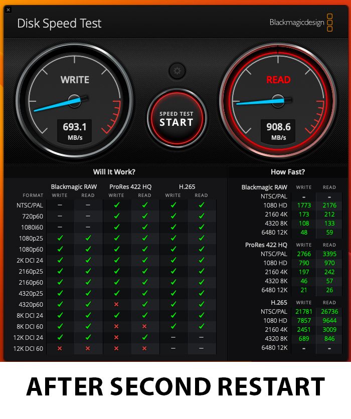

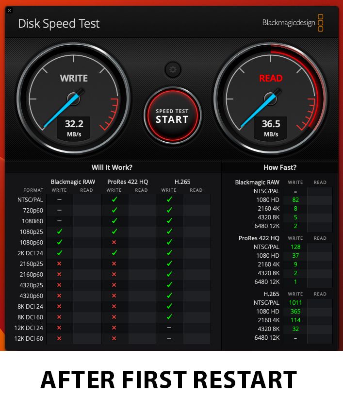

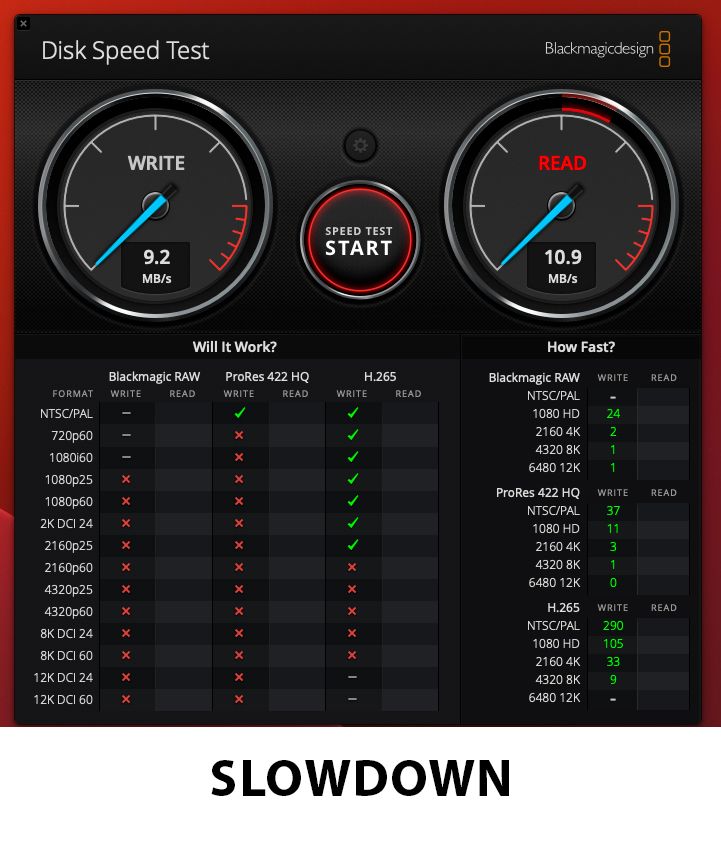

I purchased aMS510TXM switch to connect my Synology NAS1821+ to it's 10G connection as well as my Mac studio for video editing purposes, a few times the switch would slow down the network ( file transfers , NAS web interface connection, etc... ) and then just stops working bringing the NAS completely offline, in order for it to work properly i had to power cycle the switch, now i have to do that multiple times every other day, FYI: i didn't really change anything in the default settings

    Not much to see from the performance test you provided, side that it does seem to work slow, and might require second boot why ever.

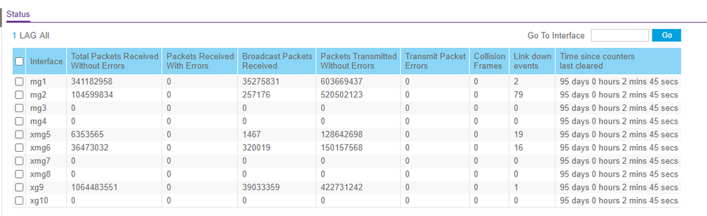

    What shows the Monitoring -> Port Statistics?
    What show the active Monitoring -> Port Detailed Statistics ... select all active ports and copy-paste the details, like the two examples. Select the list from the Web UI, paste as plain text.
    Tell us more on how the switch is connected, what 10G Ethernet is active on the Mac, ...
