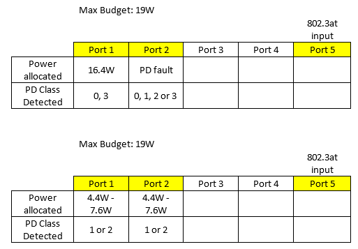

- schumakuOct 04, 2023Guru - Experienced User
Hello Ian,
In either use case, the GS105PE is powered from a GS108PEv3?
Fear you are trying to operate these devices ways out of specs 8-/
Please carefully review the GS105PE: PoE troubleshooting again.
Lets break briefly down the available power situation. The GS108PEv3 has four PoE 802.3af ports, so the power available for the GS105PE, when powered by IEEE 802.3af, :the GS105PE can power up only one Class 1/2 PoE device. Anything more that appears to work with -two- devices was possible by error only. Nothing wrong with the GS105PE and the current V1.6.0.17 firmware. Powering one Axis M1125 Class 2 is possible. Anything beyond is out of specs.
When powered by IEEE 802.3af:
The GS105PE can power up only one Class 1/2 PoE device.
For the WN370, I can't provide any experience. Indeed, can't find the PoE Class is these devices request. Based on the .Typical Power Consumption specs, with typical 5.1 W, it might be a Class 2 device. Have none of these at hand to connect to s Smart or Managed PoE switch to see what Class this device does request in a real-world environment.
Assuming the WN370 is a Class 2 PoE device (max 7.6W), and the second device you like to power is the Axis M1125, also a Class 2 device (max 7.6W):
Powering these two might be possible if you use a 802.11at PSE to power the GS105PE
When powered by IEEE 802.3at:
The GS105PE can power up only one Class 0/3 PoE device or two class 1/2 devices.
Related to the WAX214, I doubt this is a PD Class 1 device (some docs refer Type 1 ... this is not the same pair of shoes). Sure, a WAX214 can be operated on a 802.11af PD, very likely it requires all power capacity for it's own, so Class 3 (or Class 0) with 16.4W power allocated. No way to operate such a WAX214 in parallel with another PoE device on a GS105PE. That other device would get a PD fault signaled and unlikely to be powered reliably.,
Sorry for bringing your hopes back to the hard standardization world in the PoE arena. PoE, the unknown creature 8-/
Regards,
-Kurt
