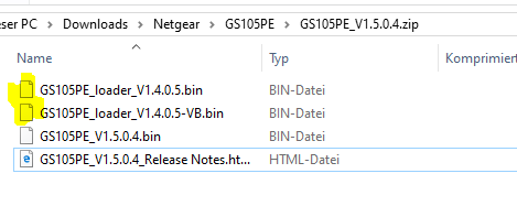

I downgraded the FW to 1.4.0.6 and then stepped through every iteration from FW1.4.0.6, 1.4.0.9, 1.5.0.4 (where BL version V1.4.0.5-VB made an appearance), FW 1.5.0.5, 1.6.0.3, 1.6.0.4, 1.6.0.6 as per switches 7&8.  The bootloader on Switch 6 would not upgrade to V1.6.0.1-VB.  How can I force it to do this.  Any advice appreciated
    As you correctly mentioned, only 1.5.0.4 firmware came budled with the 1.4.0.5 bootloader versions for the two chipset/hardware versions. To my knowlege, no bootloader updates were made available after that (up and including 1.6.0.6 firmware).

        Again, based on the available GS105PE firmware kits: In absence of an included newer bootloader, there can't be an intention that the V1.6.0.1-VB bootloader should be installed as part of the update procedures for now. Back to the reported problem...
