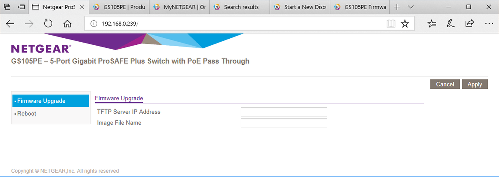

At stage 9 the switch rebooted but did not use DHCP any more and went back to its default IP address 192.168.0.239. However I did find it and openned the web page.
The web page went straight to the Firmware Update page and did NOT give any indication of which version of bootloader is needed.
I am unsure what to do now - is it asking for one of the bootloader files from the zip package - if so which one? The instructions warn against using the wrong one.

      I managed to resolve the problem last night. The steps I did were;
    • Firstly in the Configuration Utility I noticed the the G105PE had a '*' next to the name. I figured this probably meant something and assumed it meant that it was running in some sort of recovery mode.
    • On the web page I was being presented with (see first post in thread) I browsed to the firmware image "GS105PE_V1.5.0.4.bin" again and hit Apply. The switch then updated again and this time when it rebooted it went back to using DHCP address and did indeed give a a Bootloader update webpage that did also tell me which file to use.
    • I then completed the upgrade from step 9 - and it is up and running OK.
    I can only assume that the first attempt at the firmware upgrade failed for some reason and involked some sort of fallback mode (maybe just the bootloader giving a simple web page to allow a FW image to be programmed again)?

    Some time passed since we've updated a bunch of GS105PE to the current v1.5.0.4 firmware. I'm convinced there was a different Web page shown - including the information on the boot loader version - following the successful firmware upload.
    Leaving the chipset used aside, there are two GS105PE models. The GS105PE is coming in the wider enclosure, the GS105PEv2 is coming in a narrow one. Both have dedicated v1.5.0.4 firmware downloads, the firmware is not the same:

    Ensure first you picked the right firmware kit, or download the correct one fitting to your model!
    Upload the appropriate firmware image GS105PE_V1.5.0.4.bin or GS105PEv2_V1.5.0.4.bin at the firmware upload page you currently see.
    Convinced following the update there will be a dedicated prompt for the bootloader.- which are again specific versions for the v1 vs. the v2.

        Just some further notes for others:
        I don't think the PE variant of this switch has a V2 version. (Can't find it anywhere).
        I just realised that the web page that I uploaded the FW to the second time is not the one I had on my first post in this thread. I don't have a screen shot now - but it simply asked for a FW image and had a browse button. Possibly the switch had been through a power cycle yesterday (as my microwave clock was flashing when I got home).
