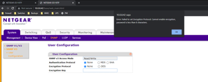

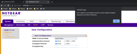

Netgear GS110TP - Error when trying to enabled SNMP v3 - Error: Failed to set Encryption Protocol
I am trying to configure SNMP v3 for two GS110TP (2nd Generation) switches both running latest firmware (5.4.2.36). When selecting user configuration I get the following error: Error: Failed ...
- Jun 30, 2022
I figured this out in case some one has same issue.
The issue was the default admin account had a password less than 8 characters. The SNMP v3 admin credential and the switch local admin password have to be greater than 8 characters for this to work.
