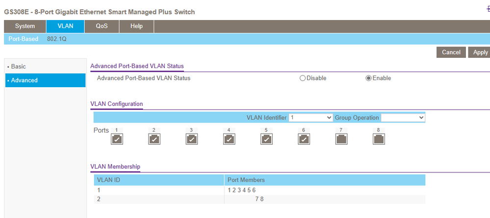

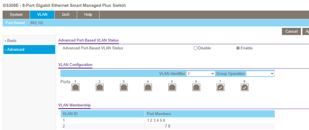

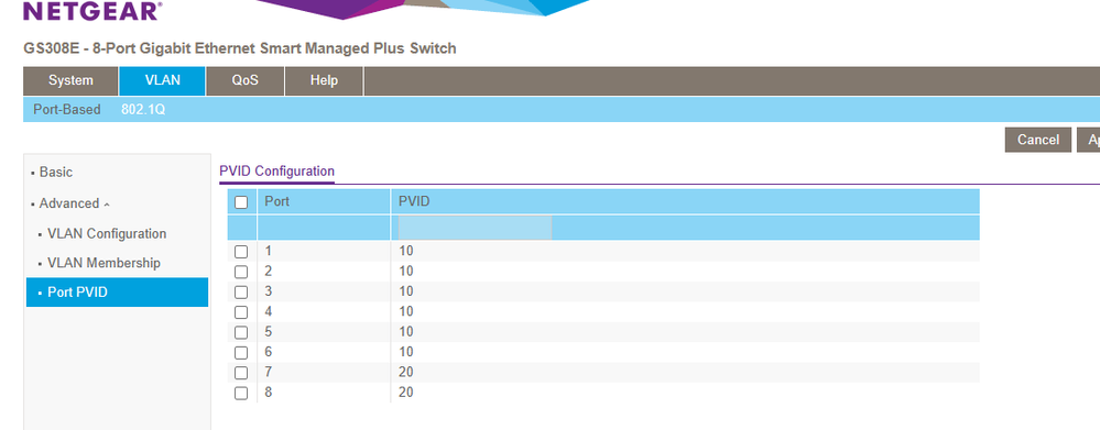

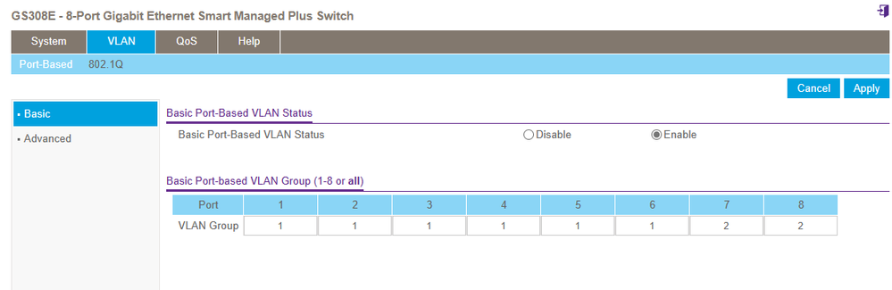

    Assuming you don't have to care which VLAN ID is used for these two isolated networks, you have two possible options:
    Basic Port-Based VLAN
    or Advanced Port-Based VLAN
    In both examples, I have used the ports 1..6 (like for your primary LAN) and the ports 7...8 (like for your isolated guest network) in dedicated, port-based networks.

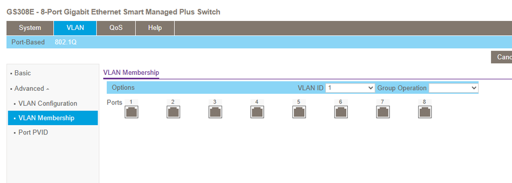

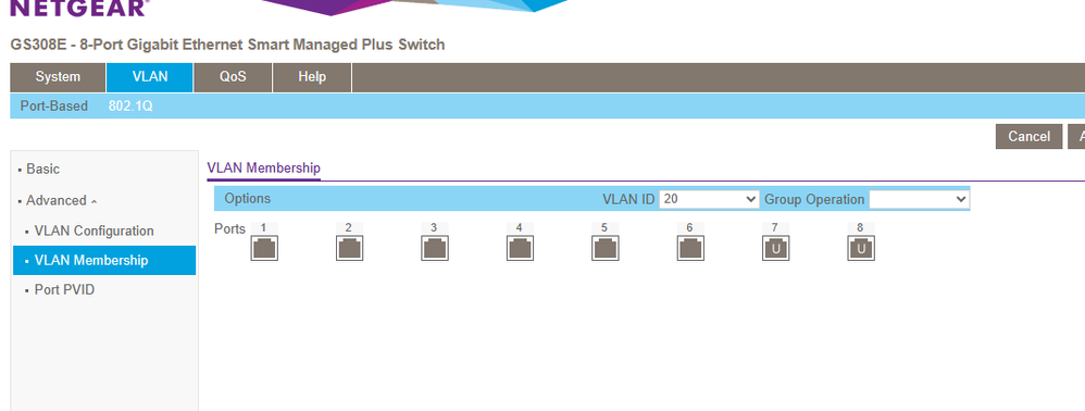

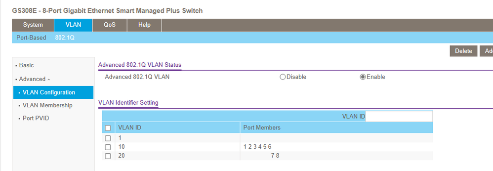

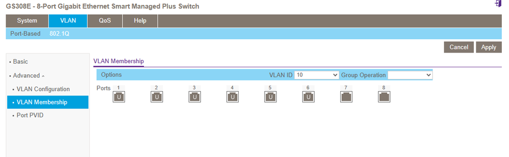

    Of course, you can take the hassle of a full Advaced 802.1Q based VLAN config:
    This is what you want to achieve on a 802.1Q configured network:
    Nothing tricky, you just need to define the VLAN 10 and VLAN 20 untagged (access) ports, and don't forget to remove all these from VLAN 1, and finally set the PVID for the access ports accordingly.

      • schumaku's avatar
        schumaku
        As your router is not VLAN-aware, there are two port types. One for the normal LAN, one for the Guest WiFi.
        In each of my examples, I had the idea for the normal LAN on ports 1..6 (one of these does connect to a router generic LAN port, and the ports 7 and 8 carrying the Guest WLAN, where you connect the Guest-LAN port from the router and the wireless access point.
        Unless you have a wireless access point supporting two VLANs with two SSIDs. This would break off the port based config, and you have to go for the 802.1Q advanced one, and configure one port for carrying both networks, where either both would be tagged, or for simplicity have the default LAN untagged (where also the access point configuration would reside), plus one tagged for the Guest VLAN.
