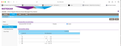

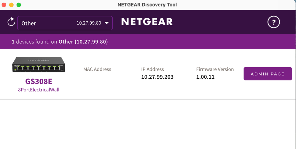

I'm attaching a few screenshots, and please let me know what else you would like to see on the PFsense side (or anything else).

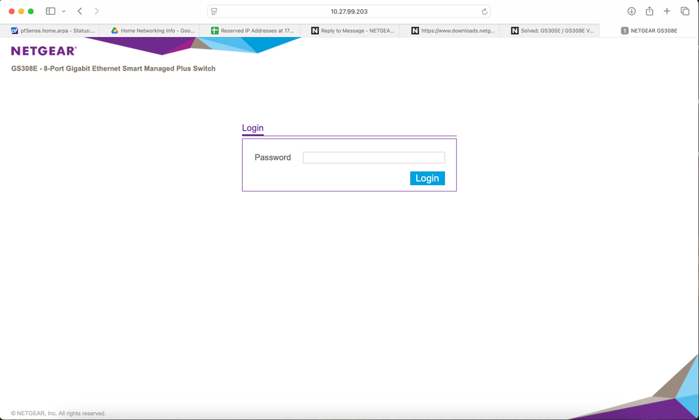

2 of the shots are examples of me being able to access the web interface of 2 existing switches on my network.

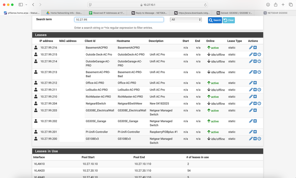

The PFSense screenshot is of my "trunk line" DHCP leases showing that the IP address that I can't reach (10.27.99.204) is not being used by another device on my network.
As an aside, while troubleshooting this I discovered that my original netgear smart switch (the GS108Ev3 at 10.27.99.200) is also not reachable via the web interface, but that is the very first switch in my network and has been running for a few years as I expect it to.
Both these switches are showing as "Idle/Offline" via the PFsense screenshot, but again, I know they are online and working, as my network is up and running.

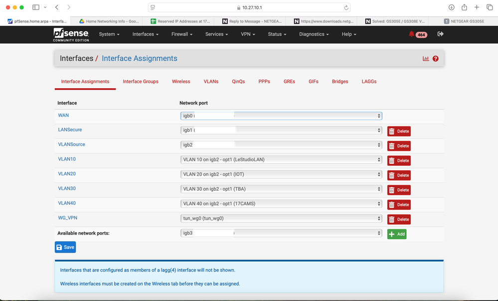

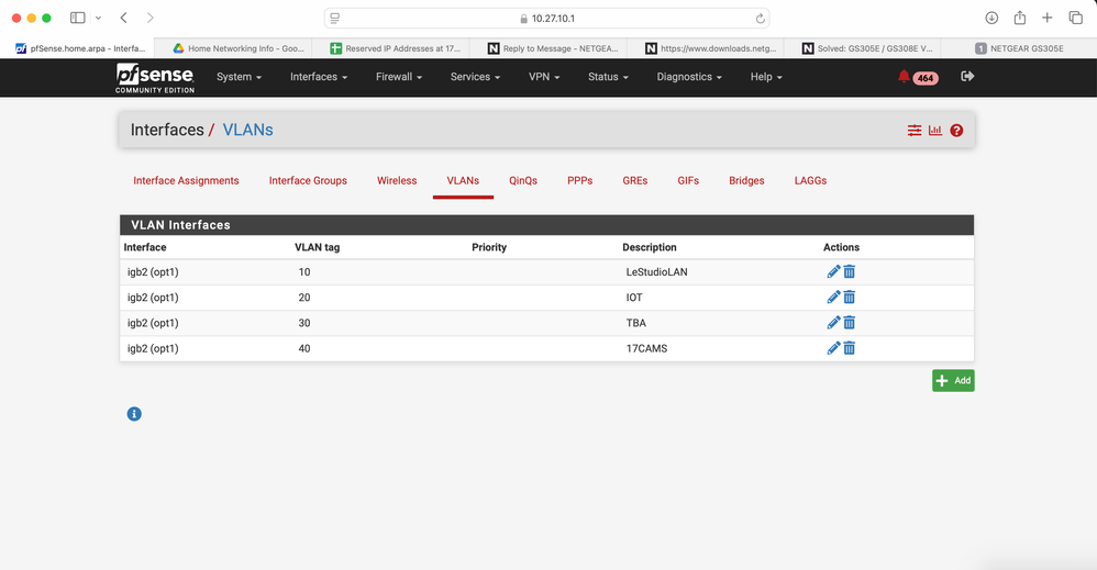

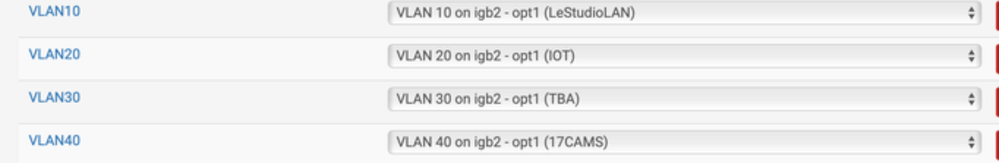

I'm also attaching 2 more screenshots of my VLAN setup via PFsense.

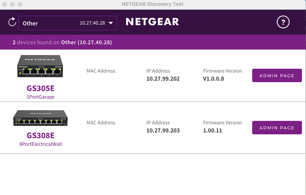

Just a couple more details. I connected my laptop directly to the switch on 2 different ports. One that is setup for my VLAN 40 and one that is my "trunk line" 99.
The VLAN 40 connection found 2 of my other switches via the Netgear Discovery Tool, but the 99 connection only found 1 of them. Seems odd, but figured I'd share.

One point I don't yet understand: These two ports on your security appliance for connecting the VLAN 10, 20, 30, and 40 - are these [T]agged or [U]ntagged?
This looks to me (on the first view) like four ports [U]ntagged, so access ports for each of the four VLANs.

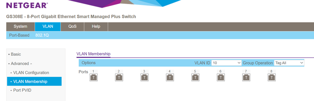

Start with the default config om the GS308E, and set it to 802.1q mode.
Add VLAN 10, 20, 30, and 40.
Go the VLAN Membership, and select the respective VLAN, start with 10.
User Group Operation: [Tag All], then [Apply].
Repeat for VLAN 20, 30, and 40.
While talking: The reason you are able to discover the two GS305E and GS308E from the VLAN 40 (from an IP address in the ,40.x range) is that somehow any other switch and/or what is defined as VLAN 40 on your security appliance is somehow misconfigured (or completely unconfigured, or simply cross connected).
The discovery utility won't show any GS305E or GS308E(PP) model (in my testing) if connected to a different VLAN -and- IP subnet - so no NSDP is used anymore, it's pure SSDP. Some older GS1xxE(xx) might be discovered, because these are sill supporting NSDP and have never been updated.

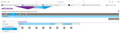

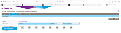

On one of my switches I have VLAN10 assigned to Port 1. I have VLAN10 as “Untagged” on Port 1, but tagged on port’s 3, 7 and 8. The thought process here was that on port 1, the only thing that would be going through that port would be items that should be on VLAN 10.
Port's 3, 7, and 8 would be carrying all data via 99 that would need to be segregated elsewhere.

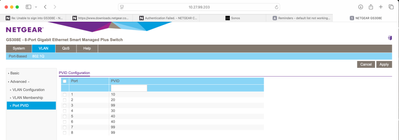

Here are some screenshots of the setup on one of my other switches:
