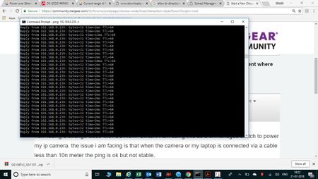

rto comming on gs110tp
I am facing a strange issue with GS110TP switch. I am using this as a unmanaged switch to power my ip camera. the issue i am facing is that when the camera or my laptop is connected via a cable less ...

Jul 24, 2018NETGEAR Employee Retired
Hi jimuth,
Welcome to the community! :)
From the screenshot posted, it seems that it is normal. If ever the time goes beyond 100ms frequently and it increases as well, then there might be an issue.

- jimuthJul 24, 2018Aspirant
dear dane
please find my reply to all of the question asked
1. Was everything working fine before?
its a new set up
2. Are there any changes on the network setup recently?
not applicable
3. Are all the IP cameras and the LAN port of the laptop support Gigabit ethernet connection?
LAptop support Gigabit ip camera support 10/100 only
4. Disconnect the GS110TP switch from the existing network. Connect one (1) camera and a laptop directly to the GS110TP switch. Then, set a static IP address on both IP camera and laptop. On your laptop, do a continuous ping to the static IP address of the IP camera. Does same problem occur? Post a screenshot of it.
Yes same problem occurs, the rto increases with cable lenght and after 25 meter it comes to rto
5. Perform a factory reset on the GS110TP switch, then repeat step 3. Does same problem occur? Post a screenshot of it.
Did a factory reset and the problem is same

- jimuthJul 29, 2018Aspirant
Hi Dana
Lots of thanks
Your solution really worked. Thanks a ton
