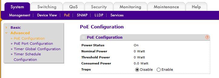

Results:
- Both cameras has Link Status = Down and are not powered at all
- In System->PoE->PoE Configuration, "Power Status" = On, but both "Nominal Power" and "Threshold Power" = 0 Watts

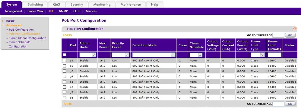

- In System->PoE->PoE Port Configuration, "Admin Mode" = Enable for both Ports (g1 and g2), "Status" appears to be Disabled

- Unless I'm missing something, Nominal Power and Threshold Power should be greater than 0, and related to the "global" available power for PoE feature.
- I've tried to change Detection Mode, but I receive always an error
- If Admin Mode is set to Disable, I can't set it back to Enable unless device is reset to Factory Settings (tryed with port g3)

      However it seems that only port 4 is able to provide poe, while port 3 emits an audible electrical noise. I'm going to return this unit to the reseller.
