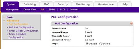

Hello Community, I'm having problems while trying to get PoE working. I'm trying to power two IP cameras compatible with 802.3af Configuration: - GS110TP reset to factory settings, then upd...

Oct 02, 2017Aspirant
Hi JohnCarloV,
I'm sorry about not providing a feedback, I wasn't at home to test it.
However it seems that only port 4 is able to provide poe, while port 3 emits an audible electrical noise. I'm going to return this unit to the reseller.
Thank you very much for your help!
Regards,
Marco
