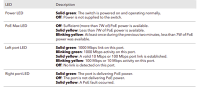

The basic LED status for the right port LED does not say anything about slow flashing. What could this mean?
