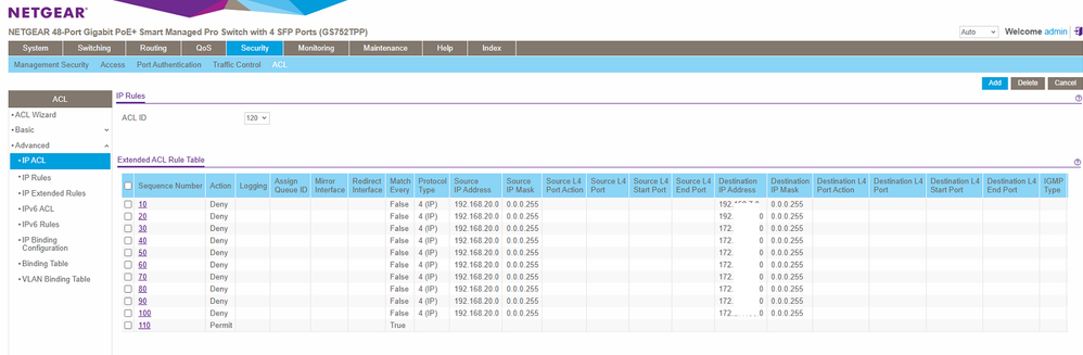

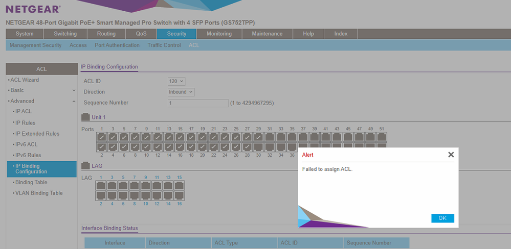

Hello,
I'm having trouble assigning an ACL rule to the switch ports
and I can't figure out what's missing in the configuration I'm trying to set up.
The switch primarily serves an office (the switch is connected to the main one via a truck on two ports) where I have the same VLAN 20 on 45 ports.
For that VLAN, I created an IP ACL with 11 sequences.
My intention is to apply it to the ports with that VLAN, so in the "IP Binding Configuration" section, I selected ACL ID and started checking the relevant ports, but I can't get past 29 ports out of the 45 I should theoretically reach. How can I resolve this and configure it correctly so that the rules are applied to all ports affected by VLAN 20?
I'm probably using the wrong approach. Can someone clarify?
Thank you.

 The number of ACL entries by ACL rule is limited - that's why you can't add more to the ACL #120.Consider creating and maintaining multiple ACL rules instead. No idea why people are hiding simple RFC1918 IP addresses in the screenshots, there is no need to - these address ranges are known worldwide, are the same, ...
