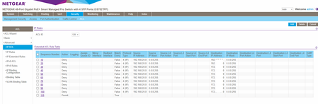

Hello, I'm having trouble assigning an ACL rule to the switch ports and I can't figure out what's missing in the configuration I'm trying to set up. The switch primarily serves an office (the switch is connected to the main one via a truck on two ports) where I have the same VLAN 20 on 45 ports. For that VLAN, I created an IP ACL with 11 sequences. My intention is to apply it to the ports with that VLAN, so in the "IP Binding Configuration" section, I selected ACL ID and started checking the relevant ports, but I can't get past 29 ports out of the 45 I should theoretically reach. How can I resolve this and configure it correctly so that the rules are applied to all ports affected by VLAN 20? I'm probably using the wrong approach. Can someone clarify? Thank you.GS110EMX & Livebox 7
