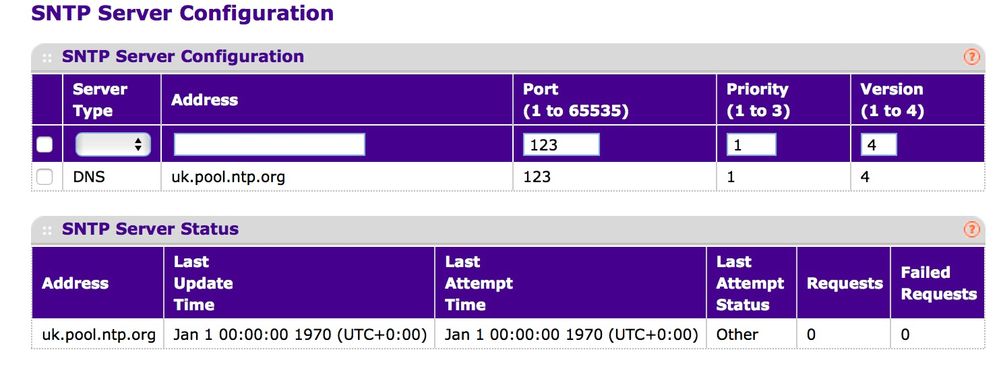

Time Configuration problems on a GS724Tv4
I am having problems getting the SNTP Time Configuration client to work. Its doesnt even look like its trying to get a time from any server I enter. Has anybody got any advice on how to make it work?...

Ive set the detail as DaneA discribed and still can not get the switch to correct its time. Cant see why this is so complicated. Any more ideas please.

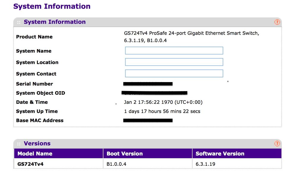

- jdenverJul 24, 2017Aspirant
Hi DaneA
Unit and Firmware is GS724Tv4 ProSafe 24-port Gigabit Ethernet Smart Switch, 6.3.1.19, B1.0.0.4
I have a Virgin router set to DMZ mode into a Draytek Vigor 2830 router with the time set on the draytek using pool.ntp.org and the time is correct. The Draytek router then connects to the GS724 switch. The Draytek router address is 192.168.1.1 and the switch is 192.168.1.2.
Havent tried a factory reset as yet.
