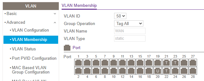

I'm trying to establish a connection between a VM to a physical router. I want to validate that I've configured everything correctly on my NetGear XS728T ProSAFE 28-Port switch to facilitate this connection.
On a high level, this is the flow of data
VM > Port Group on VLAN 50 > vDswitch > NetGear router > Physical router
My VM is on VLAN50.
On the NetGear switch, I've configured the switch ports (21-23) that are connected to the VM hosts to be tagged ports assigned to VLAN 50.
Based on what I read, tagged = trunk, untagged = access port.
The physical router is connected to port 20, untagged.
On the VM, I cannot ping the physical router if the Port Group is on VLAN 50 configured either as an access or trunk. The only time ping works is if I remove the VLAN configuration entirely from the Port Group. I THINK I configured everything correctly on the Netgear side of things but I hope someone here can confirm. I've done a lot of reading but I've yet to find a description of how to trunk between ESXI/Vcenter and a Netgear switch.

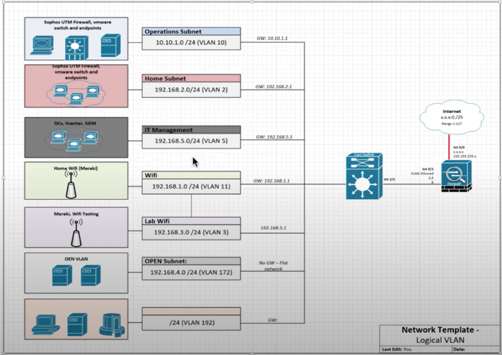

Start with providing a basic design document for what you like to implement, with VLANs, IP subnets, ..., like this generic example (which can be right or wrong):
