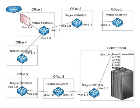

VLAN between GS116Ev2 & PowerConnect 6248
Hello. I have the attached network with netgear vlan config (above) on all the netgear switches. Vlan 1 - 192.168.1 Vlan 8 - 192.168.9 I can ping 192.168.9.1 (FW vlan interface) from any ...

schumaku
Jan 24, 2018Guru - Experienced User
Show the VLAN Memberships page for VLAN 1 and 8 on the Netgear switches.
