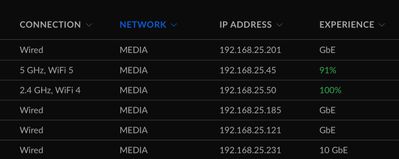

The UDM-PRO sees and assigns IPs to all the VLAN 25.
The first 5 devices are physically on the GS72TP. The last one (.231) on the XS708T.
The devices on the GS ping to each other no problem, but they do not see the one on the XS (and viceversa).

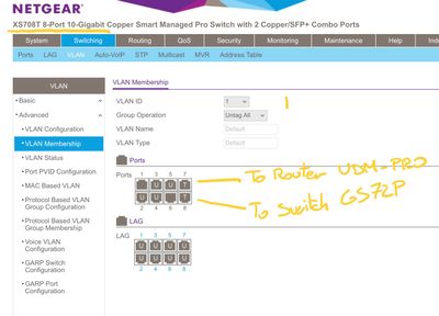

This is the default VLAN membership for the XS:
PORT 7 and 8 are Trunk connections to the UDM-PRO and GS switch, respectively.

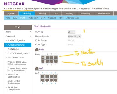

This is the VLAN 25 membership for the XS:
PORT 1 and 6 are VLAN 25 members. PORT 7 and 8 are Trunk connections to the UDM-PRO and to the GS switch, respectively.

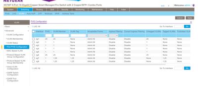

Here are the PVID configurations for the XS:

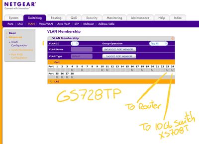

And this are the VLANs membership settings on the GS.
Default VLAN first (see below). The PORTS 23 and 24 are Trunks to the Router and the XS switch, so I thought they should be Tagged… but the GS won’t let me change the default VLAN membership.

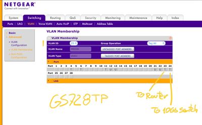

and VLAN 25:

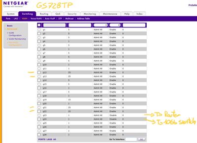

PVID configurations on the GS:
I’m sure I made an obvious mistake somewhere… this is not my field and I’m literally losing sleep over this problem, so any insight is very welcome!
