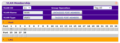

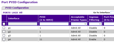

I have setup a VLAN with my GS728TP as per the diagram below and it is working OK. It's fairly simple, packets on g1 ingress tagged with VLAN 11 and egress untagged on g4. Untagged packets ingressing g4 should egress g1 with a tag of 11. The help is a bit vague though and I'm trying to determine what the "VLan membership" and "Port PVID Configuration" menus do. It appears to work fine without touching a thing in "Port PVID Configuration" however the manual says to have incoming packets tagged I need to set the PVID of g4 to 11.
VLAN11 ------- g1 ------- g4 ------ Untagged
Enabling these options makes the VLan work as expected
I have tried different configs here and everything I've tried has no effect. I have set enabled/disabled, vlan 1 and vlan 11 on g1 and g4 in various combinations.
    There seems to be some misunderstanding on the nomenclature and the simple way VLAN-capable network switches are working.
    Defining the PVID does not tag anything, it just does send the untagged frames to the defined switch internal VLAN pipe.
    Said this, untagged frames ingressing on the port defined can be assigned just to one single VLAN in the switch. The untagged frames on this port are assigned into the VLAN in the switch.
    Sometimes it's allowed to "overload" a port (or LAG) definition, only one VLAN should be configured as [U]ntagged on a port.

      Thanks for the reply. The point I'm trying to make is that the packets ingressing into g4 get tagged with vlan 11 whether I have PVID set to 11 or 1. It seems that setting U on that port for VLAN 11 causes the incoming packets to be tagged, and setting PVID appears to do nothing.

        The tagging is applied on the egress, not on ingress port. As I wrote before, the PVID definition does make the switch to put untagged ingress frames to the VLAN designated by the PVID. So the PVID config does not nothing, and untagged ingress frames can be sent to one VLAN lane only.
