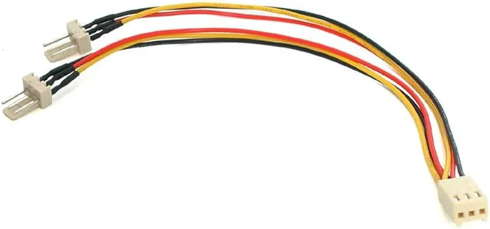

I too had a XS724EM in which all three fans spin at startup but only one remained active afterwards. It turns out only one of the internal fan headers was functional. What I did was open up the switch and connect all the fans to the working fan header with a 3-pin fan splitter cable. Ideally, the cable should be a 3-pin splitter as shown in the attachment, not a 4-pin splitter.
    This makes all fans operating on parallel, the other fans can no longer be controlled or monitored...

      Once the non-spinning fans were connected via the splitter to the responsive fan, they all finally began spinning post-startup. At this point, the XS724EM was able to maintain a stable temperature and did not freeze. Once again, being a 10Gbe switch, the unit was not "cool" to the touch but cool enough to not become unresponsive. I left it running in this manner in my homelab for several days and did not experience any freezing at all once all three fans were connected in parallel via the splitter. Only then did I feel confident deploying the unit into the field.

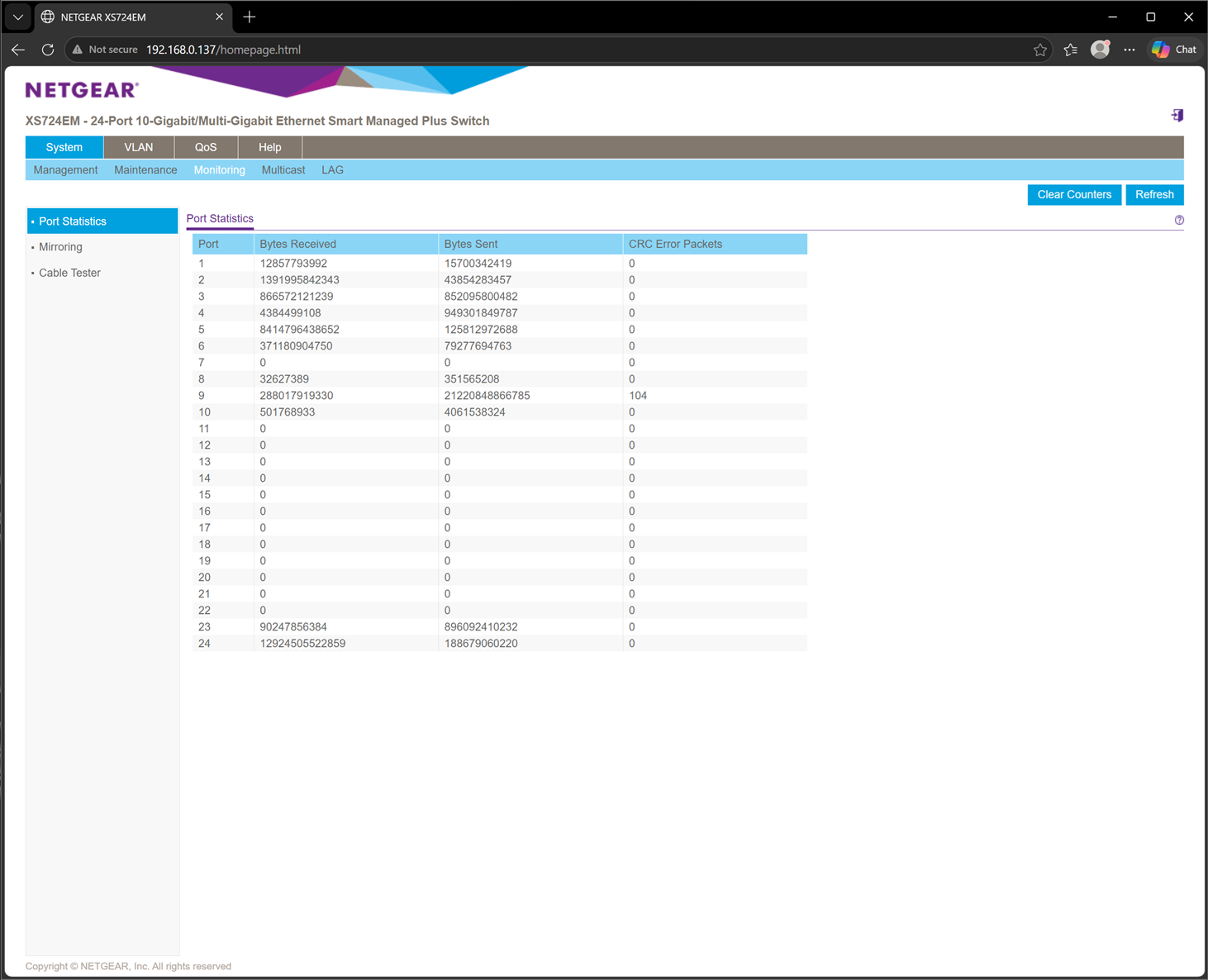

      The XS724EM web configuration page does not allow fans to be monitored or controlled (see attached image).

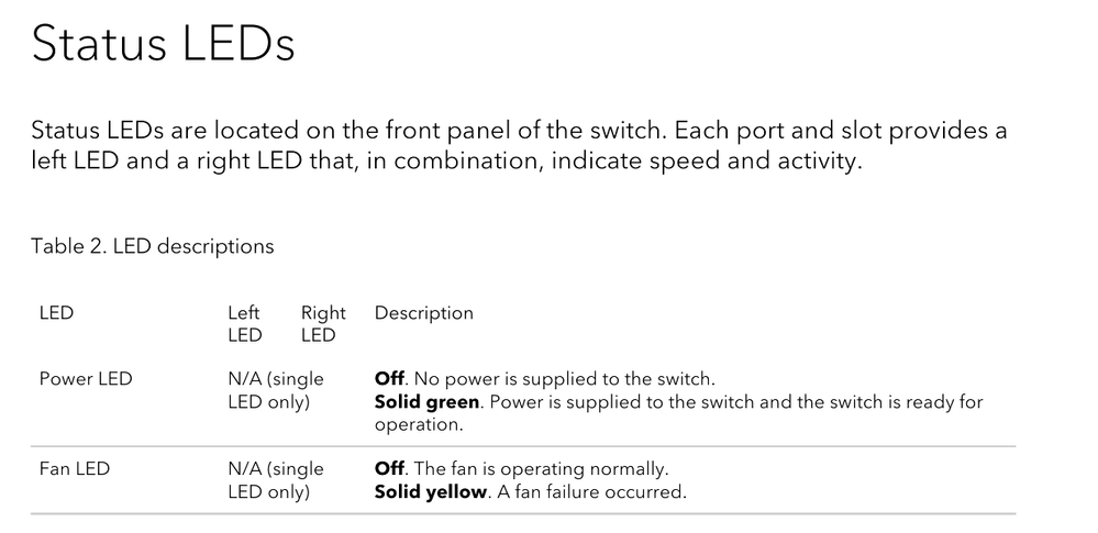

        The fan speed is controlled by the hardware. By product specification applicable to the Easy Smart Managed switch model line the fans and thir activity are not visible in the Web UI, and not controllable.
        The only indication on the FAN status is given by the Fan LED on the front.
