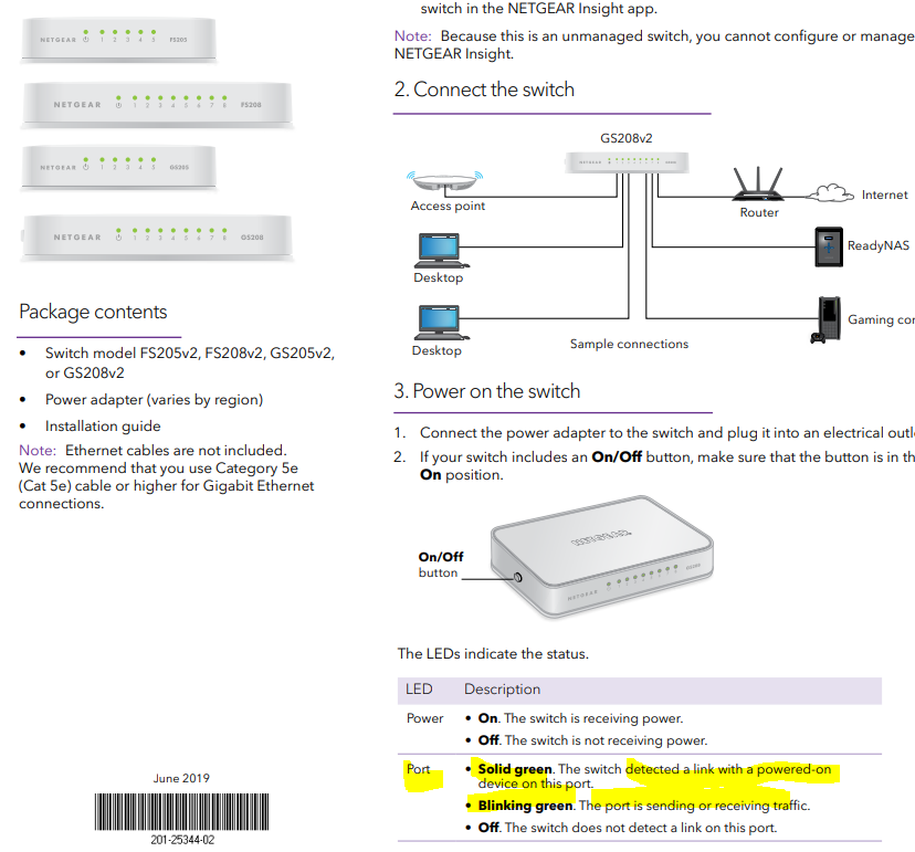

  • schumaku's avatar
    schumaku
    Do the port LEDs of the connected devices show an active Ethernet link (on) and activity (flashing)?
