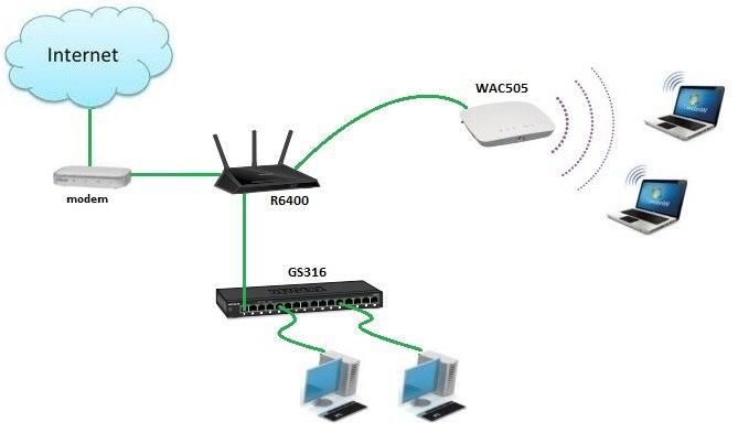

    I'm afraid that the only way is to properly set it up.  The proper order of the connection of your network devices should be: SpectrumPC15--R6400--GS316.
    Since you need WiFi coverage in the living room, I suggest you to deploy an Access Point to the proper network setup I mentioned.  For the Access Point, I recommend you either the WAC505 or WAC510.  The proper order of the connection of your network devices would be as shown below:
