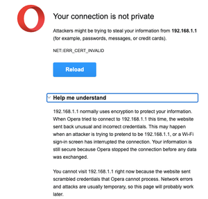

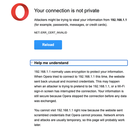

i can't log in (192.168.1.1)- web browsers don't allow it
chrom and opera don't allow to log in 192.168.1.1. firefox allow to log in 192.168.1.1 but pw does not work. i have come through this situation almost everytime i try to log in. is this normal...

Absolutely common - it's not possible to get a workable certificate on a private network https device, unless you have a fully blown DNS, trusted PKI/CA, .... - so no other way than adding an exception or allowing the connection every time.
Check the browser makers resources on how to deal with self-signed certificates which can't be validated.
